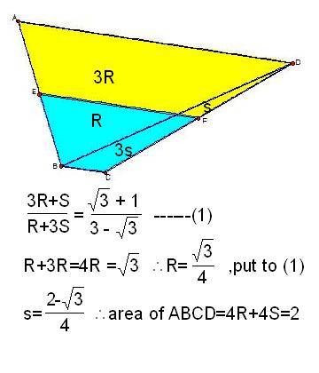

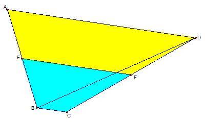

A trapezoid ABCD ,AD // BC ,points E and F are midpoints of AB and CD respectively
(1)area AEFD :area EBCF =($\sqrt 3+1) : (3-\sqrt 3)$
(2) area of $\triangle ABD=\sqrt 3$
please find the area of ABCD

Re: another trapezoid
the diagram has been changed now

If $AD = x$, $BC = y$ and the perpendicular distance between $AD$ and $BC$ is $h$, then
area of the yellow region $AEFD$ is $\frac12h\bigl(\frac34x + \frac14y\bigr)$,
area of the cyan region $EBCF$ is $\frac12h\bigl(\frac14x + \frac34y\bigr)$,
area of the triangle $ABD$ is $\frac12xh$.​
Then (2) tells us that $\frac12xh =\sqrt 3$, and so $xh = 2\sqrt3$. From (1) we get $$\frac{\frac12h\bigl(\frac34x + \frac14y\bigr)}{\frac12h\bigl(\frac14x + \frac34y\bigr)} = \frac{\sqrt 3+1}{3-\sqrt 3},$$ from which $(3-\sqrt3)(3x+y) = (1+\sqrt3)(x+3y)$. Thus $(8-4\sqrt3)x = 4\sqrt3y$, from which $y = (2-\sqrt3)x/\sqrt3$, and $x+y = 2x/\sqrt3.$
The area of $ABCD$ is $\frac12(x+y)h = \frac12\,\frac2{\sqrt3}xh = \frac1{\sqrt3}(2\sqrt3) = 2.$
VERY clever, Opal; what a "nice" way to get "x + y" (Clapping)
Noticed that the "work" can be reduced quite a bit by letting y = 1.
Quickly leads to:
(3x + 1) / (x + 3) = (1 + SQRT(3)) / (3 - SQRT(3)),
then x = SQRT(3) / (2 - SQRT(3))
