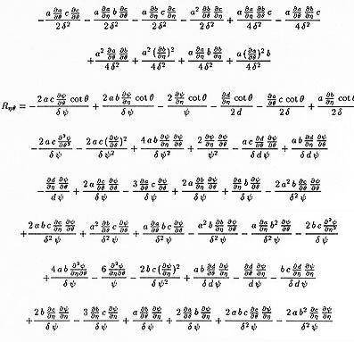

Einstein's General Relativity is the theory of the interaction between matter and spacetime. There is a system of equations, the Einstein Field Equations, that uniquely determines the 4-dimensional curvature in a region given the distribution of matter and energy.
The EFE are a system of 16 highly nonlinear coupled partial differential equations in 16 unknowns. Unless you have a truly exceptional backround in physics, it is unlikely that you have encountered anything like this. Without the aid of specail notations, it is essentially impossible to express the tens of thousands of individual terms (all quadratic differentials). Here is an example of one of the 16 components of the Reimann curvature tensor (which is highly simplified due to symmetry) which is just one a part of EFE:

could you explain a bit more about theis EFE, you are right i have never heard of it... and am fairly surprised to hear it exists...but then again what exactly is it, or its point? i could use a more in depth explination... and while I am not a physics genious just yet, i can handle all the equations you throw at me. so in such a manner direct me to anything that may help (tensor calc more likely then not, i believe i should be able to atleast determine a good amount of the reason for such equations with the equations themselves and defined variables)
in that thumbnail just about all i can make out is some wave functions, and what may be some sigmas... i relate sigma with bonding generaly, what is the use for it here... and what are those reallly blurry smaller symbols :P
