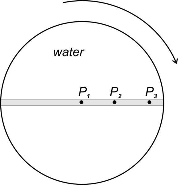

2) a small container of water is placed on a carousel inside a microwave oven, at a radius of 12.0 cm from the center. The turntable rotates steadily, turning through one revolution in each 7.25s. What angle does the water surface make with the horizontal?

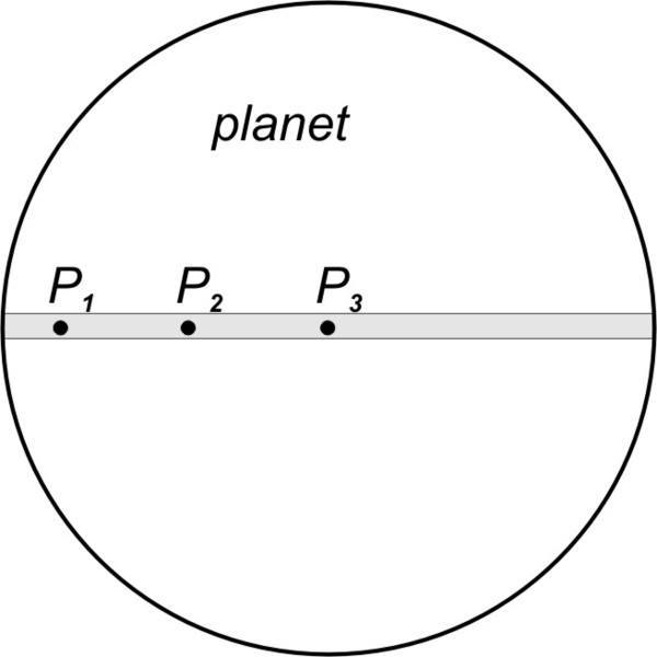

since the pilot is moving in a circe with a constant sped we know that he is accelerating towards the centre of the circle. The resultant force that he experiences must therefore always point towards the centre of the circle. This magnitude of this force can also be calculated from the given data. what you need to do is to draw a force diagram of the pilot and equate the resultant force to this centripetal force, since all the forces added up togehter must supply the centripetal force.
The first attachment shows across section through a planet's interior. As one moves towards the center of the planet the pressure increases due to the compression of the matter by the weight of the outer material. In the second attachment a container of water is spun around it's center. Here we find that the pressure is a minimum at the centre and a maximum at the outer regions (how do we know this?). What causes this difference in pressure as we move to outer regions? How is this pressure difference generated?

in #2, I'm stuck on how you would use the revolution/s within Newtons's laws to find the angle at which the water surface would make with the horizontal.. what do they even mean by HORIZONTAL?
Horizontal means what it usually means. If the carousel wasn't turning, the water level would be horizontal, just like usual. Hint: Find the acceleration, then find the direction of apparent gravity. (The surface of the water will be perpendicular to the apparent gravity.)

why would the centrifugal acceleration be away from the centre, since centripetal acceleration is normally towards the centre?
The "smartass" answer is that the word centrifugal means "away from the center" and the word centripetal means "toward the center". (Sorry... couldn't resist. o:) )
The real answer is that you can look at this problem from either of two reference frames:
(1) If you view things from the rotating (non-inertial) frame, then there appears a centrifugal force (acting away from the center). Thus the apparent weight will be the sum of [itex]mg[/itex] acting down plus [itex]ma_c[/itex] acting outward.
(2) You can also view things from the usual inertial frame. Apply Newton's 2nd law to an element of the water surface, realizing that in this frame the water undergoes a centripetal acceleration.​

as for question #2) above, for the microwave question, when solving for the angle why is it theta=arctan centripal acceleration/gravity? I've figured out that much, i just don't comprehend the theory behind it.
You might find this thread helpful (Although the problem discussed is different, similar considerations apply): https://www.physicsforums.com/showthread.php?p=769852
