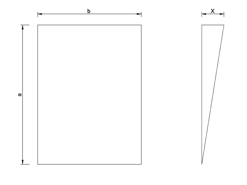

Hello,
I'm in the process of creating a calculation spreadsheet with Excel. In this spreadsheet I need to calculate a volume of an object that has an arbitrary cross-section but from the side of the cross-section, it is always triangle.
At the moment the spreadsheet calculates the volume of a circular or a rectangular cross-section. This I was able to achieve by integration. The cross-section can be created by giving the coordinates for the vertices.
Does anyone have any ideas of a formula or equation, if you prefer, that could calculate the volume when the cross-section truly is arbitrary?
PS. I tried to attach an image of the object that would've perhaps given you a better understanding of what I mean but if you do not see it, then that means the upload button is not working.

What do you mean by "from the side of the cross-section"?
How is your volume defined?
The upload works, but it looks like a wedge where the volume calculation is trivial.
I will make some assumptions about your problem. Suppose you have a cross section of area A on the XY plain (z==0). Suppose that the entire object surface has every point on the boundary going straight back to a single point with value z0. Then the volume will be 1/4 * z0 * A.
CORRECTION: @mfb has corrected me. With these assumptions, it should be 1/3 * z0 * A.

I mean that looking from the side, the object looks like a wedge or a triangle. What do you mean how is the volume defined?
Yes, calculating the volume when the cross-section is a rectangle is simple but the problem is, it could be any shape. Of course if you think it is still trivial then by all means care to elaborate.
Factchecker can you please explain what this z0 is? I have a feeling it is the center of the cross-section and in that case your equation only works for the picture I posted which was only supposed to give you an idea what I was talking about.

The real problem is getting the center of the volume for me. If we imagine that the cross-section is in the xy-plane then I'm interested in xy-coordinates of the center.
If you can forgive my silliness and help with with this problem that'd be great.
Cokemaster said:
Calculating the volume is trivial as mentioned earlier which would be Area multiplied by half the thickness, right?
I assumed that the area shrinks to a point. Then it is area multiplied by 1/3 the thickness. If the area shrinks only along one axis to a straight line, it is area multiplied by 1/2.
That might be harder. Do you mean center of gravity assuming uniform mass or centroid?

I want to emphasize that the object is always on one side this triangle shape. I forgot to draw it in the picture but one of the angles in the triangle is 90 degrees.
By center I mean centroid.

Cokemaster said:
For example let's take a case where the cross-section is 1/4 of a circle, the only way I know, is to calculate that by integrating.
If the volume is going from the base area to a single point, 1/3 * area * height (orthogonal to the base area).
If the volume is going from the base area to a single line parallel to the base area, 1/2 * area * height.
In other cases, things get more complicated.

For the volume of a wedge? It is as simple as the area of a rectangular triangle, multiplied by the height.
Cokemaster said:
Yes, to a single point it makes a sort of a cone. How did you even come up with that based on the picture?
I didn't, FactChecker introduced it in post 3.
Cokemaster said:
Also, no the volume of the wedge with the 1/4 of a circle is not 1/3 * area * thickness or 1/2 * area * thickness
Ah right, the 1/2 applies to a special case only. I don't understand how a wedge-like structure with a quarter circle as base and planar surfaces would look like.
In general, you can divide your volume into a finite number of tetrahedra, and sum their volumes.

Here I'll show you mr. Trivial
I don't think that applies to the wedge in the picture.

The surfaces are not planar.
Sure it does. Its volume is a*b*X/2.
a*X/2 is the triangle.
Cokemaster said:
Can you please provide some sort of an example, I have never done anything like that.
See figure 2.9 here for example.

The idea is correct yes, but the problem is that the height a keeps changing. So no, it does NOT apply to it.
Thanks for the link.
Cokemaster said:
I have no idea what that means.
Which part is unclear? Your figure has bent surface areas, at least in your sketch.
