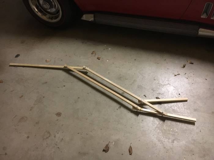

Hello all!
I'm dead-set on building a pair of articulated costume wings that open and retract on their own, preferably controlled by a remote.
The actual wing design and everything else seem to be pretty simple (building the first prototype tomorrow), but I have no idea where to begin with installing a battery-powered mechanism that will open and close the wings.
Ideally the rig will be relatively quiet but able to handle the load without trouble.
Any and all suggestions/advice would be greatly appreciated!

Your biggest challenge is going to be the superstructure - the struts (the bones) that support the weight and torsional forces.
You've got to start with that - it will drive all other aspects of the working device.
Okay, so I need to figure out how the moving parts on the back plate will attach to the base edge of the wings and move them before I should consider the motor/battery? Makes sense. I'll draw up some plans after I build the wing prototype so that I can see exactly how it needs to move. Thanks!
Perhaps play around with four bar links?
I'm not sure what you mean by that =\
I did end up building the prototype of a wing today. It needs some tweaks, but it's a decent first step. Next step will be figuring out how it will need to move when attached to the back plate. It's pretty much a copy of the wooden wing displayed in the first video at 3:10.
Looks a bit like a 4 bar link :-)
