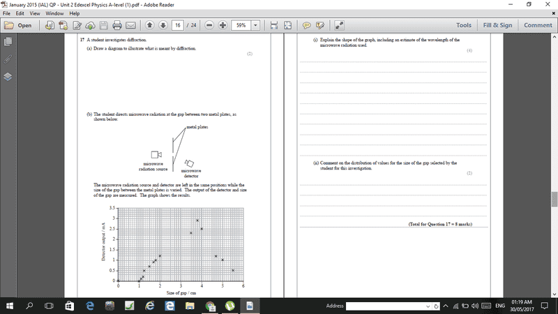

Q17, part (b) i
Please explain
This is what the markscheme and examiners report say
I need a good explanation mainly the reason of the wavelength being 4cm
Ms:
Wavelength approx. 4 cm (Accept specific value from 3.5 cm to 4 cm or a range)
What don't you understand about the explanation given?
The part in ms where it says, "there is a large angle of diffraction but most of the wave (energy) is reflected". What angle are they talking about?
Look at the diagram in part b. Draw a line from the source running straight through the slit. Now draw a line from the slit to the detector. The angle is the angle between the two lines you just drew.
Likes Javeria
Ohhh right right, thank youuu
So the point is that even though the angle of diffraction is increasing with smaller gap the intensity of the waves is reducing and most of the waves reflect which is why diffraction doesn't occur.
