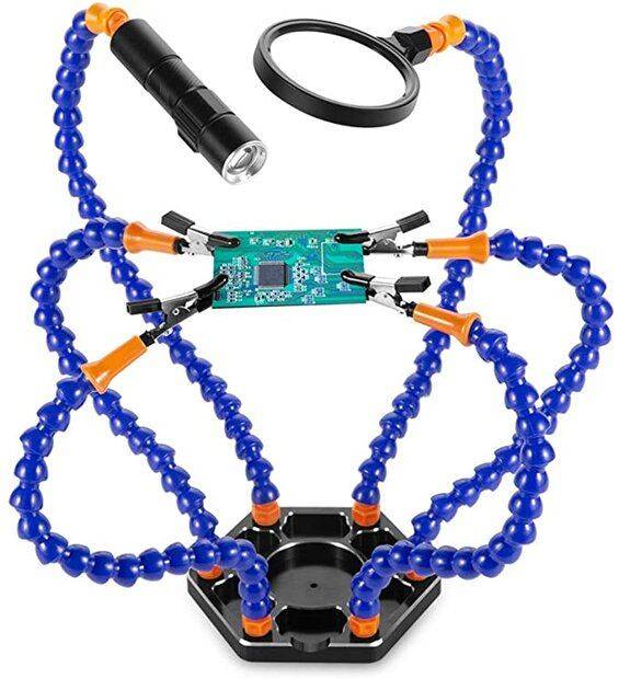

Only half joking here. How complex are your requirements?
