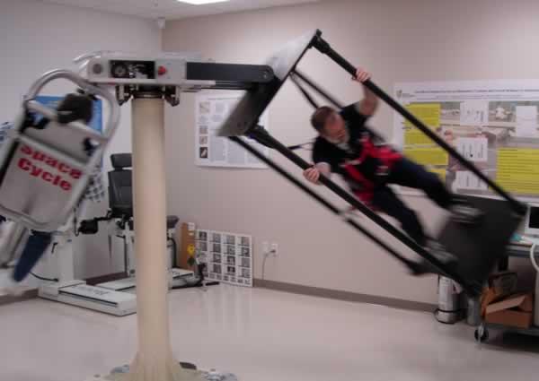

What is Y? Vertical to the ground, or vertical to the cabin, that aligns with the effective gravity (vector sum of Earth's gravity and centrifugal gravity)?
Thanks for your answers guys! I mean y in the conventional sense if you were standing still on Earth, so vertically. The centrifuge you show in the picture isn't like the one I saw. The one I saw was and video where with cabin that the astronauts sit in that spins around horizontally. When they try to lift their hand up (vertically) in the cabin they can't when the g's build up but I don't understand why because the vertical g-force is still the same without being in the centrifuge as the centrifuge is not spinning in the vertical (y) plane?
then show us your centrifuge.
It spins horizontally, but banks to align with the effective gravity.
The type of centrifuge I have seen in films of Space Training had a much larger radius. This ensures that the simulated g force is more even, over the trainee's dimensions. The 'banking' can be achieved by just having the seat / cage on a gimbal , which would not involve the long arm leaving the horizontal plane.
