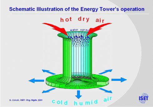

There is another interesting method to use this
http://en.wikipedia.org/wiki/Energy_tower_(downdraft)

Pressure alone will not generate Electricity. To get energy, you need a force (or some pressure) and you need motion (or a flow of fluid).
Your suggested system would work for one shot only. You would then need to pull the rod out again (supplying your own energy) and start again. The atmosphere would only be acting like a spring, to store energy - and not acting as a source of energy.
The Energy Tower and, of course, wind turbines, work because there is a net movement of air, along with a pressure difference. A vital difference there.
