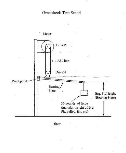

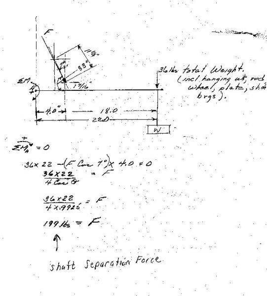

anyways, there's a beam w/ a weight on the end. total=36 lbs. Its 22 in. out from a pivot on the wall. 4" out from the wall and 1 7/16" up from the beam there's a 4.5" pully. There's also another pully above that, and a belt between those two. The beam sags 7 deg. from wall to tip under load. How much force on the belt?

Please International system, please!
metric
36 lbs =16.33 kg / 160 Newtons force down
22 IN = .56m
18 IN = .46m
4 in = .10m
1 7/16 = .037m
4.5 in = .11m
