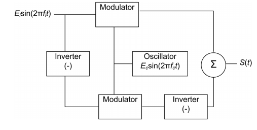

The figure shows a balanced modulator. Inputs to the top modulator are the information
signal and the carrier signal and the inputs to the bottom modulator are the inverse of the
information signal and the carrier signal. Then the output from the bottom modulator is
inverted again before being added to the output from the top modulator.
a. Derive an expression for the output signal s(t).
b. What are the frequency components present in this signal?
c. Efficiency of an AM modulator is defined as ratio of the power in the side bands
(actual information) to the total transmitted power. Calculate the maximum efficiency
of the DSBFC modulator we studied in lectures and the modulator in this problem.
Discuss the difference in efficiencies of the two systems.

a.
The output of the top modulator is:
[tex] (E_c+E_i*sin(2\pi*f_i*t))*sin(2\pi*f_c*t) [/tex]
The output of the bottom modulator is:
[tex] (E_c-E_i*sin(2\pi*f_i*t))*sin(2\pi*f_c*t) [/tex]
This is then inverted, so:
[tex] -(E_c+E_i*sin(2\pi*f_i*t))*sin(2\pi*f_c*t) [/tex]
and summed:
[tex] s(t)=2E_i*sin(2\pi*f_i*t)*sin(2\pi*f_c*t) [/tex]
Using Trig Identities this goes to:
[tex] s(t)=E_i*cos(2\pi(f_i-f_c)t)-cos(2\pi(f_i+f_c)t) [/tex]
Reaaly not sure about this? seems kind of right since the carrier band has been removed?
Where do you get Ec as your first term?
The output of the top modulator, being balanced, contains only sum and difference frequencies of fi and fc. Your expression includes a component at fc also.
[/QUOTE]
EDIT: Each modulator output can also include a dc term.
Your final expression is however close to right. very close.

Hi 92 - I had an equally hard time findng adequate literature on balanced modulators (b.m.). My textbook assumes a DSB-FC input rather than the given sinusoid, so all the derivations are meaningless unless I were to put a lot of effort into reverse-engineering the deriations which I'm not inclined to do.
I do know that the balanced modulator does not produce a frequency component at fi as you have it. I suggest you interpret the b.m. as just a plain multiplier, which will give you the sidebands at fc - fi and fc + fi. Purely as a practical matter, most b.m.'s also produce a dc output.
So I suggest you multiply Ecsin(wct) by Eisin(wit) and append a dc voltage V0 to each b.m.'s output. Then use the trig relation you cited to get the sidebands. You will find that the dc terms disappear by virtue of the final summing operation. The output is a DSB-SC modulation, the second "S" standing for "suppressed".
Actually, most b.m.'s use switching diodes or other switching methods so the "carrier" is really a square wave. By multiplying this waveform by your input sinusoid you can readily see that the actual b.m. output also contains sidebands at sum and difference frequencies of the input sinusoidal frequency and (odd) harmonics of the square wave. In practical applications these higher sidebands are filtered out of existence. This approach gives you the same output as though the carrier were also just a sinusoid. I suppose it's possible that your instructor intended for you to show these higher harmonics in S(t) though.
Some commercially available modulators act like pure multipliers for small carrier voltage amplitudes but revert to square wave modulation when that voltage amplitude is >> the input signal.

Got an email from my lecturer re this question (paraphrased)
- 'Modulator is not just a multiplier - the basic modulation DSBFC - In the balanced modulator the modulator blocks are the basic DSBFC modulators. In fact most AM modulators use DSBFC as the basic building block and add other functions to optimise the output signal.'
I think me and you both misinterpreted the question, the whole block diagram is the balanced modulator, with the two 'modulators' being DSB-FC - stupidly worded question.
This is an assignment question so he's not going to tell my ya/na- but from that I suspect that I am at least on the right track. The problem is that after reading a lot about DSB-SC I think that I should have E/2 out the front - maybe not though, I do have two (double?) sidebands and a suppressed carrier in the output signal?
-Again, really not sure because wiki has VmVc/2 -Thoughts?

Fisher92 said:
The problem with pure multiplication is that the two inverters effectively cancel each other out - mathematically they become completely pointless.
If we did have pure multiplication:
Top modulator output = Ei Ec sin(wct) sin(wit) + DC
Bottom modulator output= -Ei Ec sin(wct sin(wit) + DC
Bottom modulator output after inversion = Ei Ec sin(wct) sin(wit) - DC
Summer output = 2 sin(wct) sin(wit) = DSB-SC output.
However, this is beside the point. I also plead guilty to misinterpreting the question. Each modulator is presumably a simple, basic square-wave modulator, with the whole diagram representing a balanced modulator.
So OK, the output of each modulator will be kEi[sin(wit){1/2 + 2/pi cos(wct) - 2/3pi cos(3wct) + ...}]. k depends on the particular circuit gain.
This output contains wi and frequency components (nwc +/- wi), n odd.
Just use that output and its inverse to get the b.m. output. The output will contain a component at wi and all the difference frequencies. All these terms are usually filtered out so only the two sidebands wc +/- wi appear at the output.

Going back to your first problem for just a sec:
the problem I had is that a basic modulator is already a DSB-SC-output device. This the case with a diode bridge or semiconducor modulator. To get a DSB-FC output you need to input E0 + Ei sin(wi t), not just Ei sin(wi t).
Anyway, assuming each of the two modulators puts out a DSB-FC signal, I am making a minor correction to your original solution which I think is what was intended, even though to me the circuit makes little sense as an implementation of a DSB-SC modulator:

back to the original question,
Taking [tex] s(t)=Ei∗cos(2π(fi−fc)t)−cos(2π(fi+fc)t) [/tex] as the answer to a,
b. would be the upper and lower sidebads, fi-+fc?
c. I need to take the answer from a. and turn it into power which I guess is a simple case of V^2/R but that will give me instantaneous power like the second question. How can I get the average powers for these? I figure that the max power occurs when the cos terms go to 1?
Fisher92 said:
Thanks again r m.
Taking [tex] s(t)=Ei{cos(2π(fi−fc)t)−cos(2π(fi+fc)t) [/tex] as the answer to a,}
Usually, fi << fc so let's call them fc +/- fi. Yes, these are the upper (+) and lower (-) sidebands.
Average power in your standard AM signal, defined by Ec[1 + m sin(wi t)]cos(wc t) can be derived by squaring the signal and computing the time-average thereof. Don't work with the sideband expression, work with the above instead.
Hint: multiply out [1 + m sin(wi t)]^2 and then take averages of each expanded term. The next step would look like
Pavg = Avg[(Ec^2 cos^2(wc t)] * [1 + avg{m^2 sin^2(wi t)}]
You should wind up with two terms, one being the power in the carrier and the other in the modulating signal.
I'll let you struggle with this & give you a hand if needed. :smile:

P=E^2/R
[tex] P=\frac{E_c^2*sin^2(\omega_c*t)}{R}+\frac{(\frac{mE_c}{2})^2*cos^2(\omega _c-\omega_i)}{R}-\frac{(\frac{mE_c}{2})^2*cos^2(\omega_c+\omega_i)}{R} [/tex]
so the efficiency is
[tex] \mu = \frac{\frac{(\frac{mE_c}{2})^2*cos^2(\omega _c-\omega_i)}{R}-\frac{(\frac{mE_c}{2})^2*cos^2(\omega_c+\omega_i)}{R}}{\frac{E_c^2*sin^2(\omega_c*t)}{R}+\frac{(\frac{mE_c}{2})^2*cos^2(\omega _c-\omega_i)}{R}-\frac{(\frac{mE_c}{2})^2*cos^2(\omega_c+\omega_i)}{R}} [/tex]
Setting m,Ec,R and the sin and cos terms to 1 (net +1) will give the absolute max efficiency?
[tex] \mu = \frac{\frac{(\frac{1}{2})^2*1}{1}+\frac{(\frac{1}{2})^2*1}{1}}{\frac{1*1}{1}+\frac{(\frac{1}{2})^2*1}{1}+\frac{(\frac{1}{2})^2*1}{1}} [/tex]
This gives the fabeled 33.33% efficiency for DSB-FC.
Thoughts?
Regarding DSB-SC, the same process will obviously give 100% since it is always x/x but I have read some conflicting stuff about its efficiency. Some say 100% and some say 50% inc you -so I was thinking of just saying that it is unnecessary to transmit the info twice - in the two side-bands so it could be 50% and then say something about ssb-sc??
Regarding the second question i posted, part b asks
b. If the intermediate frequency of the receiver is f_(IF), what is the maximum RF bandwidth
the device can have if the receiver is not to suffer from image frequency problem.
This must just be something about superhets I guess but I can't find it??
