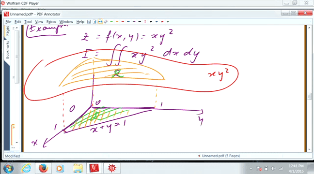

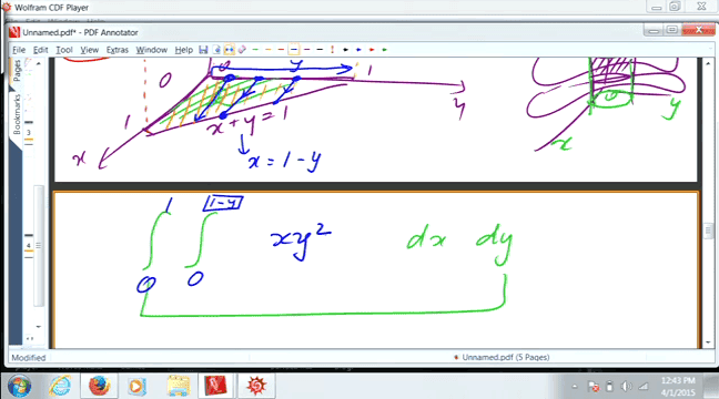

One more question.
Take this problem:
I don't get how the upper limit for x is (1-y). I get that the limits for Y is 0-1. if I get the limits for x to be from 0-1, will the surface be a square ?
Along the line drawn from (0, 1) to (1, 0), the equation x + y = 1 must be satisfied. By re-arranging this equation, x = 1 - y, which forms the upper limit when integrating along the x-axis.
If you decide to integrate in the order "dydx" so that dx is the "outer" integral, then the limits of integration must be constants so that the integral is a constant. The line x+ y= 1 cuts the x-axis at x= 1 so those limits must be 0 to 1. Now, for each x, y must range from the x-axis, y= 0, up to the boundary line x+ y= 1. That is, y must range from y= 0 to y= 1- x.
