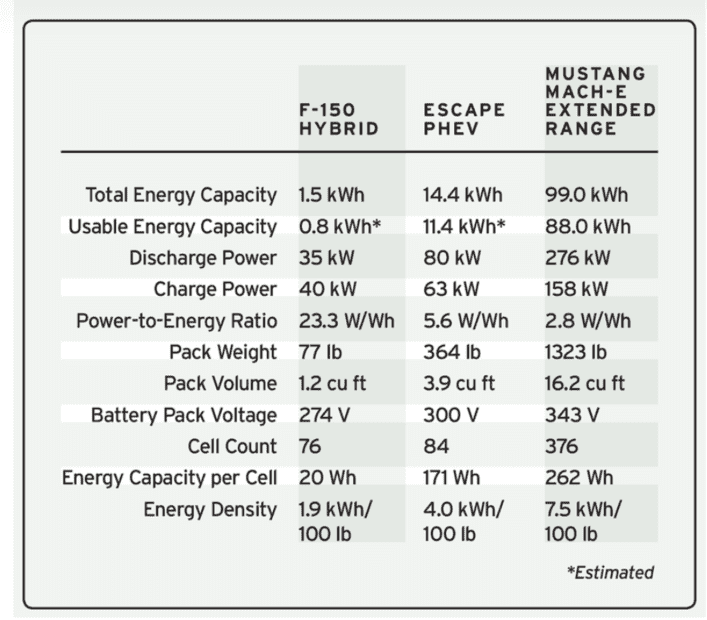

Where did you read that? Please give a link. Are you sure it did not refer to golf carts?
Here is some data posted recently.
