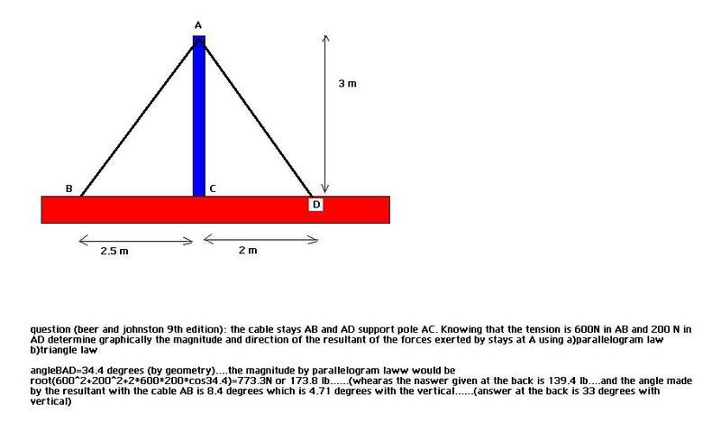

it is a request to all who are using the book BEER and JOHNSTON : STATICS and DYNAMICS 9th edition to please use this as a medium to post any errors you find in the book. It will greatly ease the process of problem solving . Thank You :)
here is one
