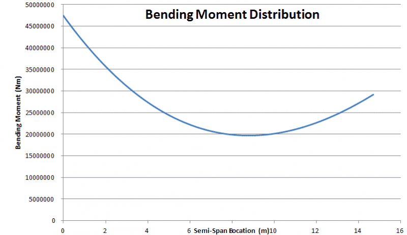

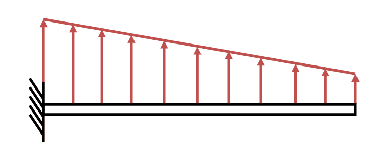

Derive the bending moment distribution of the beam:
I end up with something like this:
Im abit concerned with the profile, should it taper to zero? Any thoughts?
Thanks
Did you draw a free body diagram of this beam? Did you construct a proper shear force curve? Do these things and you will arrive at the correct bending moment curve.
Moment should be zero at free end.

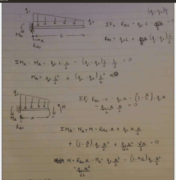

Yes I did by making a cut in the beam. I'll post up my equations
If anyone's interested, I simply forgot to subtract q2 from the q1 terms in the expression
