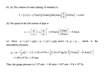

why is when working with Bernoulli equation the absolute pressure that we are NOT looking for has a gauge pressure = 0 and only atmospheric pressure while the one we are looking for has both? is this a rule somehow ?

the last part of the problem
the last part of the problem by taking the absolute pressure of the right side equal to the atmospheric pressure only by taking the gauge pressure there as 0 while in the left part we are asked to find the gauge pressure. how come one has no gauge and the other has

thats the solution
that was the solution. the last part when we applied the equation and said the gauge pressure in the right side is 0 confused me

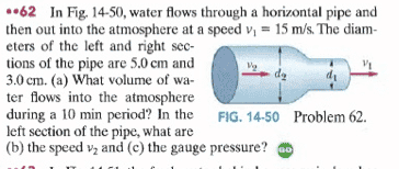

the question says that the water on the right goes out into the atmosphere
so it is at atmospheric pressure, ie the gauge pressure is 0 :smile:
