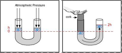

Re your post #6: let me try:
U shaped tube with liquid. Equilibrium: both sides same level, call it h.
Massless plunger ('cork' in the pic) at left is pushed down from h to 0. Costs work.
How much work ? Complicated math again (sorry). Bernoulli to the rescue :smile: !
Potential energy: gain (A to A') = loss (B to B')
Pressure energy wrt zero line:
In the left picture: average pressure ##\rho g {h\over 2}##, volume ##h\times{\rm Area}## in each leg ##\Rightarrow## pressure energy in both legs combined ## E_p = \rho g h^2 \times {\rm Area}##
Right picture: average pressure ##\rho g {2h\over 2}##, volume ##2h\times{\rm Area} \ \ \Rightarrow \ \ E_p = 2\rho g h^2 \times {\rm Area}##.
Difference ##\Delta E_p = \rho g h^2 \times {\rm Area} = p V##, exactly the outcome of the complicated math for Force times displacement.

thanks for this
can you answer my #10 and #12 questions?

You're welcome. I don't know if it helped much. By the way: the Bernoulli equation is not only for liquid flows, but also for gas flows at low Mach number (see hyperphysics: baseball curve, airfoil, )
Re #10: I thought I did already: " Check out this one "
