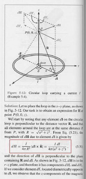

Refer to the attachment below,
anyone can explain the formula highlighted by red box? how the | dl x R | become dl only?

Note that [tex]\hat{R}[/tex] is a unit vector that is perpendicular to [tex]\vec{d\ell}[/tex].
yes, I'm understand that dl is perpendicular to unit vector of R, but how the magnitude of them become dl only?
The magnitude of any cross product is given by
[tex]\vec{A}\times\vec{B} = AB\sin\theta[/tex]
Applying this to your question, B is a unit vector and theta = 90, so
[tex]AB\sin\theta = A[/tex]
Make sense?

I not really understand about the 2nd formula, could explain more?
What aspect do you not understand? A = dl; B = 1; theta = 90.
Have you worked with vector cross products before?

why the B=1 ?
yes, I know that
[tex]
[/tex]
gsan said:
why the B=1 ?
It represents the magnitude of the unit vector [tex]\hat{R}[/tex], which is 1.
Perhaps you are confusing [tex]\vec{R}[/tex], which has magnitude of R, with [tex]\hat{R}[/tex], which has magnitude of 1?

how do u know the [tex]\hat{R}[/tex] has magnitude of 1 ?
It's a unit vector! The purpose of a unit vector is to define a direction; unit vectors--by definition--have magnitude of 1.
The little "hat" symbol ^ on top of the vector tells you that it's a unit vector. Its direction is the direction of the vector R, but its magnitude is 1.
ok, I understand why unit vector of R has magnitude of 1.
now my another question is, why we can cross product of a vector with a unit vector?
eg. vector of dl x unit vector of R
Why not? A unit vector is a perfectly good vector, just like any other.

Assuming that the vector dl is purely in the x direction (for some reason), then version 1 is correct. Version 2 treats dl as a unit vector, which it is not.
In general, dl will be in some arbitrary direction.

Yes, but the vector hat{x} dx should have components dx, 0, 0, not 1, 0, 0.
