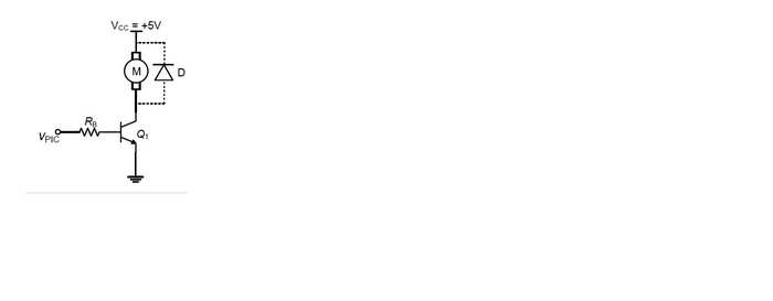

You want to use a PIC microcontroller to drive a motor in a clockwise direction at either 0% speed (when the PIC output is 0V) or full speed (when the PIC output is +5V). This motor draws 500mA at +5V while the output of the used PIC is limited to +5V and 20mA. To solve this problem you decided to use a BJT transistor that withstands 500mA as an interface between the PIC and the motor as shown in Fig 2. This transistor will play the role of a switch that turns on and off the motor while it is also able to handle the required current by the motor.
Notice that there is no need to add a limiting resistor RC in series with Q1 collector because the motor internal resistance will limit the collector current IC to 500mA at VCC = +5 V and VCE(Sat) = 0.21V.
The selected transistor has the following specifications extracted from its datasheet:
- VBE = 0.7V when the EBJ is forward biased
- 300 < hFE = Beta < 400, means that you can obtain a current gain of at least 300 (for Beta minimal) at the edge of saturation (EOS).
- max IC (Sat) = 4000mA, meaning that this transistor can withstand max 4000mA.
- VCE(Sat) = 0.21V an estimate of VCE at saturation
- VCEO = 40V, means that this transistor can handle VCE voltages up to 40V when it is
turned off
(a) Select a standard value RB that guarantees the operation of your transistor in saturation.
lots.
I am not 100% sure, because there are a lot of numbers being thrown at me, of what to do.
How I tried it was: When PIC = +5V, the current can not be larger than 20mA.
5 - VBE / R = Ib = 4.3/R < 20mA
Imotor = 500mA = Ic
Ic = (Beta)Ib
I plugged in random Resistor values to obtained an Ib less than 20mA and Beta to be between 300 and 400. I got 3.3kOhm (there are a whole range of them.
What I need to know now (if that was correct) how to prove everything else to ensure 3.3kOhm was correct.
For that 3.3k, determine base current. With that base current, determine minimum collector current and show transistor is saturated. Hence, determine collector current.
