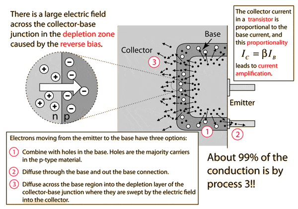

Who can explain what happens (in terms of electrons) what happens when base current is zero, especially why current flowing to collector is zero under this condition?
