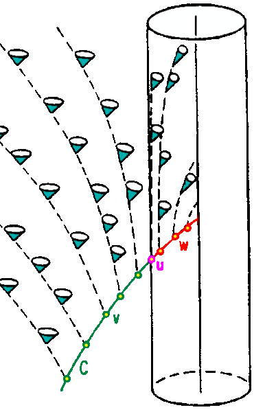

This spacetime diagram might help (adapted from Geroch's General Relativity from A to B).

I think you may need to think about this some more.
The person who is falling into the black hole can still receive signals from the outside world. But, once he passes the event horizon, he cannot send signals back.
The question arises - if you have an observer sitting at infinity, sending out pulses once a second, how many of them does the infalling observer see? He can see these pulses even after he crosses the event horizon.
It takes math to really calculate the answer - the only really interesting part of the answer is that he sees a finite number of pulses from the external observer, not an infinite number, before he reaches the black hole.
There is a fairly simple argument to show that the infalling observer can't see an infinite number of pulses, without a lot of math. You have to believe that photons are redshifted when they go "uphill", and blueshifted when they go "downhill". You also have to believe that the tidal forces near a black hole at a given point don't act weirdly as a function of velocity. You also have to believe that the observer hits the singularity in a finite amount of his own proper time.
Given all these assumptions, you can say that from the infalling observers POV, the stretching tidal forces mean that the photons from infinity have to climb "uphill" to reach him. This means that the photons are redshifted.
The point of this is that your mental model must give the following results to be correct:
Photons emitted by the infalling observer don't make it back out
Infalling photons tracing a radial path (ones that fall directly into the black hole) are redshifted when they reach the infalling observer.
The observer reaches both the event horizon (and even the singularity!) in a finite amount of proper time (umm, we're doing a non-rotating black hole here to keep life simple).
Because the infalling photons are redshifted, the observer sees only a finite number of pulses from the outside world before he reaches the event horizon (or before he hits the singularity for that matter). (Not only photons are redshifted, but any time interval is lengthend. If you send pulses out at once a second with a redshift factor of 2, pulses willl arive once every two seconds).
A model that the infalling ovserver never reaches the event horizon usually fails on this point (the finite number of pulses) - because if you think of him never reaching the point, you think that he must receive an unlimited number of pulses. This is wrong.
