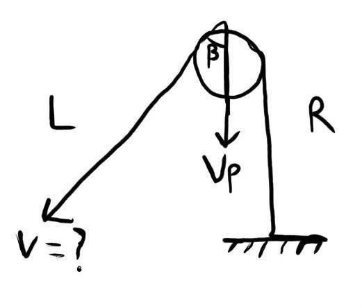

Find V if the pulley is massless, friction less and
Can take any no of variables but V is be in terms of VP.Ignore gravity and other forces
2. The attempt at a solution
If Pulley comes down by X, the length of string towards left(the side not fixed) will increase by 2X
Therefore, If in same time pulley comes down by VP, String will increase at rate of V=2VP.
.'. the answer is V=2VP
But, The answer in key states V = VP(1+cosβ)
Where am I going wrong?

The problem is not fully specified. I can justify two answers depending on what is supposed to be constant: the angle of the string or the direction of pull. To get the given answer, it has to be the direction of pull.
If the pulley comes down by X, by how much is the length of the string between pulley and ground anchor reduced? So the length of the string to the left of the pulley has increased by ...?
That argument tells you how the free end moves relative to the pulley, but to get V you need to add in a component of the velocity of the pulley.
(If taking the constant angle of string interpretation, you would add the velocities as vectors instead.)

rajumahtora said:
So for const direction of pull, is The answer is VP(2+cosβ) ?
No, the given answer is correct for that case. You didn't answer my first two questions:
1.Decreases by X
2.cant figure out
rajumahtora said:
1.Decreases by X
2.cant figure out
Does the string as a whole change length?
