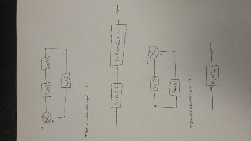

Hi
So this is how it should look with the two transformations ?
Thanks for help
It's not a transformation, it's a reduction of the Laplace transformed.
The reduced transfer function (leftmost inner loop) must be drawn as one block wherein there is a fraction: Numerator = (G1*G2), denominator = (1 - G1*G2*H1).
Otherwise your drawn transfer function will be read as: ( G1*G2 ) * ( 1 - G1*G2*H1 ).

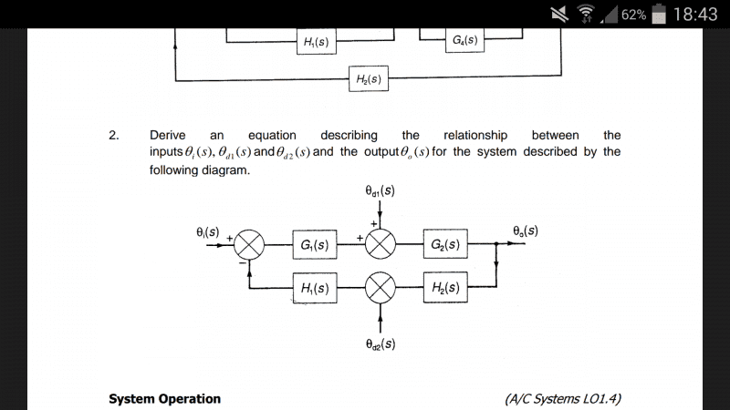

Hi which I'm put would I start with as there are 3 ? Please thanks for your help
Did you reduce the outer loop in the first question?
I don't quite understand your question ( maybe because I'm not american or english ): 3 of what? Inputs? Please reword your question.
Furthermore I don't understand what is meant by the question in 2): Describe the relationship . . . ?
You can "move" θd1 and θd2 backwards in the loop, dividing them with the transfer function they are passing by this movement. Doing this you will have one (parallel) input:
θi + ( θd1/G1 ) + ( θd2/(H2*G2*G1) ).
Having removed the inputs from the loop, you can reduce the loop, and multiply its transfer function by its 3 inputs in parallel.
( My best guess ).
