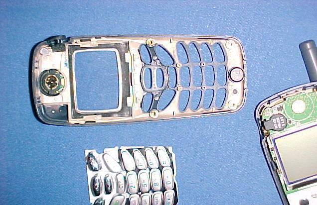

Hello,
Tonight I will commence the dissection of my old cell phone. But first a few words for the phone:
It was a faithful phone. Never loud or obnoxious. Always had full signal strenght. And that blue backlight...
Okay, ready to dissect. It's amazing how 4 years with a cell phone can change the way you think of it. Anyways...so there shouldn't be any shock risks involved right? Cell phones should have capacitors in order to create EM waves right? Well, I should be able to put pictures of the phone dissected on here. We'll see.
Here are the results. This is just a preview.

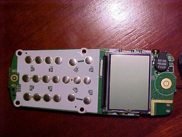

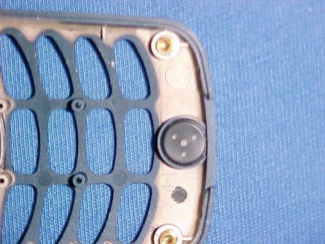

and the other two pictures...

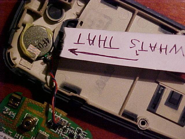

The "what's that" is the vibrator. There is a little motor that is out of balance inside that little battery-like case. If you were to cut the little wires and connect then to a AA or AAA battery then the motor would start to vibrate.

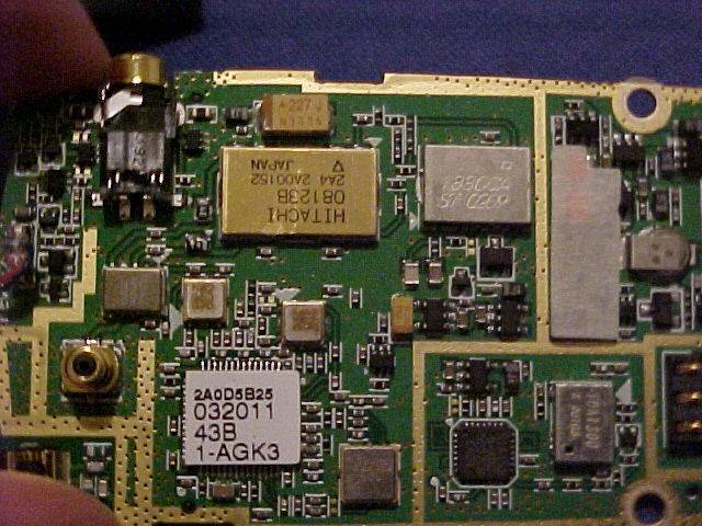

Your previous picture of the bottome side circuit:
If I were a betting man then I'd say the thing under the white sticker is the main processor. The square chip---about 5mm by 5mm---to the right of that is the transceiver(transmitter and receiver in one chip). Notice how is has a square of foil around it. That's probably a ground plane which helps isolate the transceiver signals from the rest of the circuit.
A lot of those little 1mmx1.5mm black/brown/gray chips a resistors and capacitors and/or diodes. See the big yellow thing that says Hitachi? The yellow thing with the red line above is a capacitor. There is a smaller one like it in the center of the photo as well.
The thing that says Hitachi is a power amplifier. Exactly what its purpose in the circuit is hard to say without a much closer look. It suffices to say that it takes a small signal of some sort and makes it much larger.
The thing under the sticker could be the transceiver and the processor could be the smaller chip to the right. I'd need a closer look to tell what is what.
It's amazing how much stuff is hidden inside of a little cell phone huh?
IT WORKED! It really worked. I severed the vibrator wires from their initial source and then used a nail clipper to remove some of the outer covering. Then I had to use foil for extensions...but when I connected it to a AA it WORKED!
Ha! I'm so easily amused! So you say the yellow thing w/red line is a capacitor? Any ideas for a project with that?
