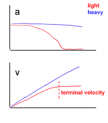

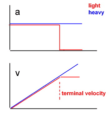

There is a final "instant" where the lighter body stops acclerating and reaches terminal velocity. The heavier object continues accelerating beyond this point.
If their momentary speeds are matched up until this point, the heavier object would then need to start accelerating *at a greater rate* from this point on. Which is ridiculous.
Why do you say that? It would continue accelerating at the same rate from that point on. The lighter one's acc. will have dropped to zero.
(1st diag. ideal case; 2nd diag. more realistic but less clear)

The acceleration curve for both objects are hyperbolic, but different in their limit, so except for the instant that they are dropped (and after both are at terminal velocity), the denser object is always accelerating faster than the less dense object.

What I meant was that if the 2 balls fell at the same rate until the light one hit terminal velocity, the heavier one would now be in a bit of trouble in achieving its term.vel. The graph would have a kink in it, which is ridiculous, therefore the original (incorrect) proposition is daft.
(if you see what I mean :yuck: )
