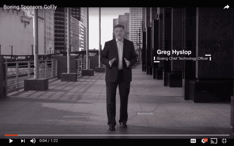

herox.com seems to be a crowdfunding site. It makes me suspicious. It lists several sponsors but no links to the sponsor sites. That makes me more suspicious.
How can you be sure this is legitimate?
Do you have a link to a Boeing site discussing this prize?
I had not thought of that, but I did click on Boeing and came up with this...
http://goflyprize.com/
It seems to be legit as best as I can tell, but then I am pretty illiterate when it comes to computer software and tech. If anything is not correct I would appreciate being informed of what's wrong.
Thanks anorlunda :smile:
I found the same link, but nothing from an official Boeing source.

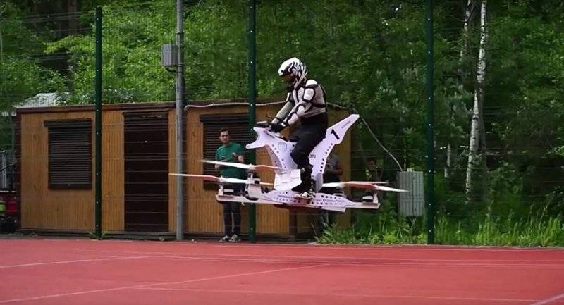

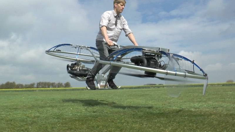

I believe this has been shown on PF in the past, but it shows how close things might be.
Make it lighter weight
Make it quieter (electric is almost possible)
Make it safe for a novice
RonL said:
80 pound maximum weight and 8.5 foot size
Seems like these concepts could be tuned to those specs. I'd like a roll-cage, though...
https://i.pinimg.com/originals/15/28/09/15280990157bbcbc7ed9e5313fb696ea.jpg
https://i.ytimg.com/vi/soxxPyaAT1k/maxresdefault.jpg
For sure we have examples of several small systems doing the job, it gets to the heart of sound abatement and a unique new method of fuel supply.

I have looked as best I know how and this is what I have concluded.
First the you tube video shows to be uploaded by a verified Boeing logo.
Second the man in the video seems to be Greg Hyslop.
Third is the Bio off of the Boeing website.
Executive Biography of Greg Hyslop, D.Sc.
http://www.boeing.com/company/bios/greg-hyslop.page
So unless someone else can show otherwise it seems legit to me.
