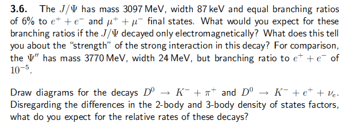

(a) What are the branching ratios for EM decay only?
(b) What does this reveal about the strength of strong interaction?
(c)What are the relative rates of decay?
Part (a)
[/B]
For EM-only decay, the branching ratio would be 50% and 50%.
Part (b)
Strong interaction is more likely to occur, since only 12% of total reaction can be attributed to EM interaction.
Part (c)
Not too sure how to approach this part..
There are more decay modes that can happen via the electromagnetic interaction.
More than 12%, as a correct solution for (a) will show.
(c) did you draw the leading Feynman diagrams? What is the difference between them?

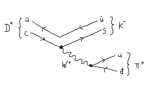

The first feynman diagram is given by:

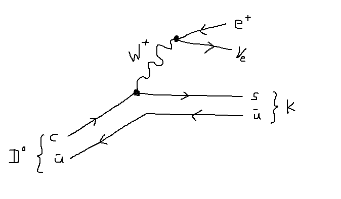

The second feynman diagram is given by:
The only difference between these two is the decay of ##W^+## lepton to either ##\bar u s## or ##e^+ \nu_e##. Which has a higher decay width ##\Gamma##, the hadronic or leptonic decay?
That's what you have to find out.

Their vertex factors are definitely different for hadron and lepton decays. For hadron decays it will be ##g_{em} \times q\bar q = \frac{2}{9} g_{EM}## while for lepton decay to positron, the vertex factor is ##+1 \times g_{EM}##. So the lepton decay has higher decay width?
The mass of a tau is not 1 GeV.
(c) you have a W not a photon, I don't think your approach works for those (you'll need it for (a)!).

True. That vertex factor thing only works for photon coupling. I'm guessing the hadronic decay is suppressed, since they are much heavier than lepton decay products (positron, neutrino)?
