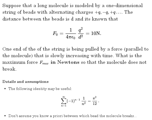

I am not sure how to proceed with the given problem. I can write down the net force on any of the charges but what should be the condition that the chain breaks? :confused:
Any help is appreciated. Thanks!

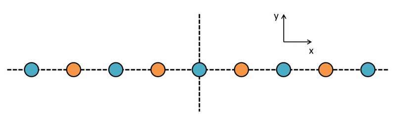

Imagine the chain breaking at some point of an infinite chain.
What is the net force of attraction between the two pieces?
Hint:
Take as origin one of the beads, considering that bead to be in the positive half.
For a bead at position -r (r>0) and a bead at position +s (s>=0), what is the force between them?

No, I meant positive half of the axis on which the beads lie. I'm supposing there is a charge at position n for each integer n.
The distance between the beads is r+s but how do I comment on the sign of those beads i.e how do I know if its -q or +q at -r or +s? :confused:
You don't care what the individual signs are - you only care whether they're the same or different. The distance r+s has enough information for that.

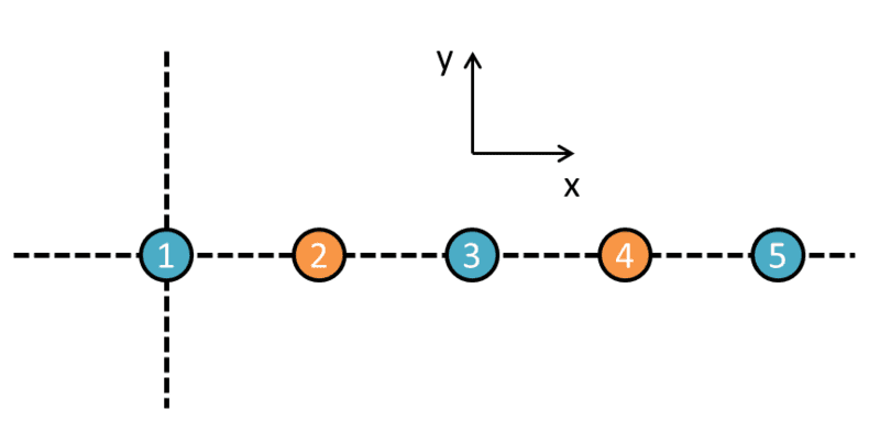

Please look at the attachment, did I interpret correctly?
The blue ones are positive charges and orange ones are negative.
Yes, except that they also go off to infinity in the negative axis direction.
How far is it from the bead at -r (r>0) to a bead at +s (s>=0)?
In terms of that distance, what is the product of the charge signs?
What is the force between the beads?
What is the net force between all such pairs of beads?

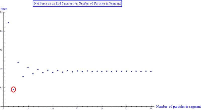

I did note that by chance ##F_0(2\frac{\pi^2}{12} - 1)## is about 6.45 N. [EDIT: I think this is the net coulomb force on the first two particles in the chain.]
But I don't see an argument for that being the answer.
Well, maybe I do. Consider the net Coulomb force on the first particle, the first two particles, the first three particles, etc.
(I'm not sure about this problem because I can't see how the molecule can hang together with just the point-particle Coulomb forces.)

Yes, I blundered. I thought I had proved to myself that adding one increased the force, but that's clearly wrong.
1:∞ gives ##\Sigma_1 \frac {(-1)^n}{n^2} = -\frac{\pi^2}{12}##
2:∞ gives ##-\frac{\pi^2}{12} + \Sigma_2 \frac {(-1)^n}{n^2} = 1 - 2\frac{\pi^2}{12}##
3:∞ gives ##1 -2\frac{\pi^2}{12} + \Sigma_3 \frac {(-1)^n}{n^2} = 2 - 1/4 - 3\frac{\pi^2}{12}##
This gives an alternating sequence converging to -ln(2), but the smallest magnitude term is the second one.

Here's a graph for fun.

I calculate the net force on the first particle already which came out to be 8.22 N. The force is towards positive x-axis.
Won't the net force on the first two particles be simply the twice of 8.22 N? :confused:
  • #33
  • #34
TSny said:
For the second particle, how many other particles are to the right of the 2nd particle and how many other particles are to the left of the 2nd particle?
To the right of 2nd charge, there are infinite charges so the force due to them is ##F_0\ln(2)## but maybe I went wrong here.
If I consider that there are ##\infty-1## charges to the right, do I subtract the force due to first charge on left of it?
  • #35
Now wait a minute. The first charge feels the force of all of the charges to it's right (essentially an infinite number). And you said that the force is 8.22 N. Good.
The second charge has essentially an infinite number of charges to it's right. How do you get that the net force of these charges on the second charge is ##F_0\ln(2)##?
Besides the force from all the charges to the right of 2, there is also the force on 2 due to particle 1 on the left. How much is that force? Is it in the same direction or the opposite direction as the force due to the particles on the right?
