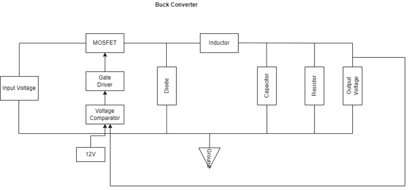

First major question is, do i need to interface a micro controller to achieve the functionality to drive the MOSFET? I am beginner in these kind of circuits. Few of the things i know is the PWM duty will be calculated as Voutput / Vinput = 12/24 = 50% duty and apply this duty to MOSFET driver circuit. But if the input is different from 12V, i am thinking that i shall read the input voltage using the micro controller and control the duty accordingly. Is my understanding correct?
Not really. A uC usually just makes it difficult (you need a software).
You might only need a voltage comparator with hysteresis.
If the output voltage is low, then turn on MOSFET M1.
If the output voltage is high, then turn off MOSFET M1.
Simulate the circuit with SPICE to check output ripple, L1 and C1.
Likes PhysicsTest

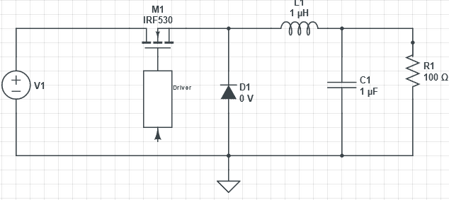

Is the above block diagram correct for the voltage comparator?
Yes.
You might simplify the MOSFET driver by inverting the circuit and using the N-chan MOSFET as a low side switch.
You do not need to compare 12 V with 12 V. You could divide the output and compare that with a lower reference voltage.
NO! This will not work. This is only a linear regulator and for the current output you need with the input voltage you want, you will likely burn up the FET. In order for this circuit to work your comparator needs to drive an oscillator (perhaps 30khz-100khz output) that has a pulse width variable output. The higher the load (the lower the output voltage) then the greater the duty cycle of the oscillator to keep the FET turned on longer.
If you are doing all this to learn about how switching regulators work, then cool, no better way to learn although you will be doing a lot of degugging. But if you need to get something running for your work or a product, then you definitely should do a search for Switching Regulator integrated ciruits from manufacturers web sites (Analog Devices, TI and so on), use their calculating tools to generate a BOM, and design the circuit around that chip. It will save you weeks of work.
Rubbish.
It is not a linear regulator, it is a switching converter.
Since the "Gate Driver" is not specifically defined in the block diagram it is rather foolish of you to post what you did. The subject of the thread is buck convertor. It should be implied that the gate driver provides an on-off signal, not functioning as part of a linear regulator.
Likes Buckethead
Perhaps, but I'm likely to think because of the detail of the block diagram (comparator block, etc.) that a block labeled simply "Gate Driver" is a simple circuit biasing the FET. A Voltage to Pulse Width Modulator would be a more appropriate name. Because of the simplicity of the original diagram I found it prudent to point out that the diagram with the Gate Driver was leading toward a linear regulator circuit and not a buck convertor.
Doesn't the freewheeling diode and series inductor give it away?

It is not anything but a linear regulator without a pulse width modulator!
Yes, of course it does. I didn't say the design wasn't moving in the right direction, I just pointed out that if you drive a FET gate with a comparator without a PWM circuit in there somewhere, even that circuit will work, but only as a linear regulator.
You are forgetting the voltage comparator with hysteresis is in the feedback loop. That makes it a self oscillating switching regulator. It PWMs itself.
Only if the voltage comparator was replaced with a linear op-amp error-amplifier would it become a linear regulator.
Likes Buckethead
OK, you are absolutely right. I stand corrected. I was looking at the comparator as operating in the linear region. Thank you for the correction. (tail between my legs).

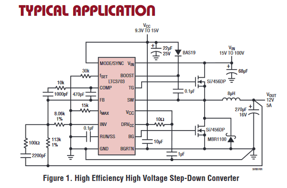

Thank you all for the suggestions, I understand it is a tough job to design the circuit on my own, i will try to learn in parallel, but i need to close this activity, i have not gone in details of why the requirements are given in such a way, as i am not much aware of the standards.
I have checked the Analog Devices website
https://www.analog.com/en/parametri...nmin|24_vinmax|100_vout|12_iout|20&p5362=Buck
I could get the following devices
LTC7871
LT8228
LTC3871
LTC3703
Please help me can i choose one of the components and go ahead with the design?
Rule #1 of component selection: Derate. I would not choose a part with a 100V absolute maximum spec for a 100V application. It is likely that you will have to create a lower voltage supply for the control IC.
Also, the controller isn't the first part of the design to worry about. Assume that you can design or buy the necessary controls later. First you need to focus on the selection of the inductor(s), the MOSFET(s) & diodes and their heat sinks, and the capacitors at the input and output. Figure out the high power part first. Then select an appropriate control scheme. When you have completed this design and it's working well, you will realize that the inductor(s), the heatsink/transistors and the capacitors (esp. cap ripple current) were the most important, largest, and most expensive parts.
Also consider that you may not have the necessary background to do a relatively difficult buck converter design quickly (yet). What about asking for help or more time? Is that better than throwing together something that isn't reliable?
I don't know your system; specifically why you need to operate from 24 -100V. But, in my former life of doing this stuff, I would put some effort into reconsidering those numbers or talking to the systems designers that chose them. You, or they, may not understand the ultimate cost of those decisions.
Finally, just to get some perspective on what this thing will look like when you're done. Look online at some other 240W 12V power supplies, don't worry about the exact specs, this is just to get an idea of how big they are, what are the significant component sizes and mechanical design elements. Hint, it's not the ICs.
Honestly, I don't think that apart from the LTC3703 you would be able to manage the others.
Likes PhysicsTest
So, i will select the components as per the application note provided in the data sheet.
Understand and select the pin configuration as per the requirement, and design the PCB. Is my design job over and then perform the testing?
The components from the AppNote 'typical application' won't do: that design does not match with your initial requirements.
Maybe you should try Webench instead.

I saw the data sheet of the LTC3703 and there was a design example on page 27, i followed the same procedure.
LTC3703 data sheet
Specifications:
VIN = 24V to 100V, VOUT = 12V, IOUT(Max) = 10A, f = 250kHz
1. RSET
As per the formula in the data sheet
RSET(kOhm) = 7100/(250 - 25) = 31.5KOhm -> eq1
2. Inductor value for about 40% ripple current at maximum VIN
L = 12/250K*0.4*10(1 - 12/100) = 10.56uH. -> eq2
3. Minimum On-time
ton(min) = 12/(100*250kHz) = 480nS -> eq3
which is above LTC3703's 200ns Minimum on-time.
4. Top and Bottom MOSFET switch
Since the drain of each MOSFET will see the full supply voltage 100V (max) plus any ringing, choose a 125V MOSFET to provide a margin of safety.
PMAIN = 1.32W -> eq4
= 96.4DegC.
=1.84 -> eq5
TJ = 70 + 1.84*20 = 106.8
5. Current Limit Resistor
RDS(ON) = (25mOhm)/2 [1 + 0.009(105 - 25)] = 21.5mOhm
IMAX pin voltage = 10*0.0215 = 0.215V
RMAX = 0.215/12uA = 18k -> eq6
6. CIN is chosen for an RMS current rating of 5A (IMAX/2) at 85DegC.
7. For the output capacitor 2 low ESR OS-CON capacitors (18mF) are used.
This is how i am approaching, i need to select the MOSFET as per the specifications and started drawing the design in LTSPICE.
