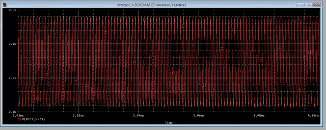

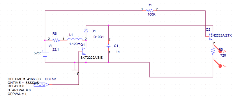

Hi I'm currently modeling a 5-12Vdc buck converter, and just out of nowhere decided to put a transistor between the output resistance and the diode. Now, this transistor is always connected to voltage so it shouldn't do anything at all, it's just a closed switch. What happens is that the transistor ends up eating a lot of the voltage. I don't really understand what's happening.
Resistance Voltage. It's 2... when it should be 12.
Actually it's a boost. My bad...
What is the V at the Emitter of Q2 Relative to the base of Q2?
Looks like that a demand for a transistor DC gain (Icollector/Ibase) must be pretty high in this example.
Check out 2N2222A transistor's characteristics curves.
