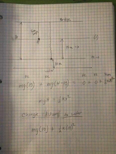

erobz said:
Draw a diagram and let's see what you are proposing.
As far as I can tell this is what was done.
Using the elevation where the jumper instantaneously comes to rest as PE = 0
They find the height ##H## of the bridge ( which is irrelevant) above PE = 0 to be given by:
$$mgH = \frac{1}{2}kx^2 = \frac{1}{2} \cdot 25 \cdot 15^2 = 2812.5~\rm{J}$$
Then they must be assuming from that point they have additional 10 m gravitational potential to the water.
$$ mg10 + \frac{1}{2} \cdot 25 \cdot 15^2 = 55 \cdot 9.81 \cdot 10 + \frac{1}{2}\cdot 25 \cdot 15^2 = 5395.5 ~\rm{J} + 2812.5~\rm{J} = 8208~\rm{J} $$
Not a perfect match?
Actually, it is a perfect match if you use 9.8 as the value for ##g##
Not a perfect match?View attachment 318962

It says the jumper comes to rest 10 m above the water. That is the position where the spring is fully stretched.
okay, so what's the stretched and unstretched length here?
The unstretched length is irrelevant. But you could figure it out from finding ##H## in the diagram I provided.

Here is how one gets the quoted number $$\frac{1}{2}(25~\text{N/m})\times (15~\text{m})^2+(55~\text{kg})\times \left(9.8~\text{m/s}^2\right)\times (10~\text{m})=8202~\text{J}$$The interpretation is that the cord starts exerting a force on the jumper immediately after the jump, the gravitational potential energy is measured from the level of the water and the bridge is 25.0 m above the water.
I think you can analyze it as though it does have a free length.
Set PE = 0 at water(like you've done)
Let the height of the bridge above the water be ##H##.
Then you can analyze it from the point where the spring starts to stretch to where they momentarily stop:
$$ mg ( 15 ~\rm{m} + 10 ~\rm{m} ) + mg ( H - (15 ~\rm{m} +10 ~\rm{m} )) = mg (10 ~\rm{m}) + \frac{1}{2} 25 \rm{ \frac{N}{m}} (15 \rm{m})^2 $$
$$ \implies mgH = mg (10 ~\rm{m}) + \frac{1}{2} 25 \rm{ \frac{N}{m}} (15 \rm{m})^2 $$
but it seems to be a very small free length...never mind...negative free length. SMH...

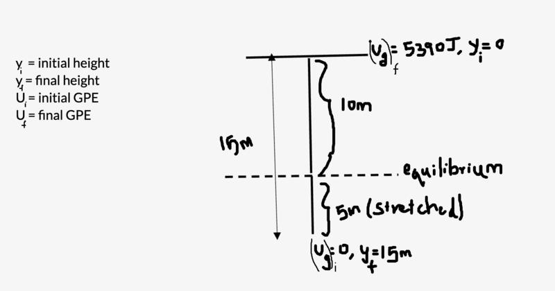

We often tell students off for simply putting the numbers they are given into the first equation that comes to mind. But, in this case:
$$m = 55kg, g = 9.8 m/s^2, h = 10m \ \Rightarrow \ PE_1 = mgh = 5390J$$$$k = 25 N/m, x = 15m \ \Rightarrow \ PE_2 = \frac 1 2 kx^2 = 2812.5J$$$$PE = PE_1 + PE_2 = 8202.5J$$And don't worry about having too many significant digits in the answer. Just plug and chug and everyone is happy.

If 25.0m is the height of the bridge, why we don't plug in GPE (mgh)?
  • #32
There are many interpretations that you discuss here I'm finding challenging to understand. Although I am aware that the question is flawed, I would greatly appreciate it if someone could elaborate.
  • #33
The interpretation that "makes sense" the bungee has no free length so that it starts applying the force immediately after the jump...unlike an actual bungee that would allow for some amount of free fall. The other issue is that the bungee has somehow stopped the jumper while applying much less force the jumper's weight. If you just hung the man (without them jumping off the bridge and gaining kinetic energy) the stretch of the spring would be larger than the quoted 15 m. Others are talking of work not being conserved to make sense of it... I think the question is just a blunder.
