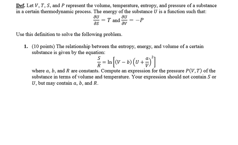

Calc 3/Thermo differentiation
In summary, Chet said that if you substitute in U=2RT-a/v for U in the answer, you get p=RT/(v-b)-a/v^2.

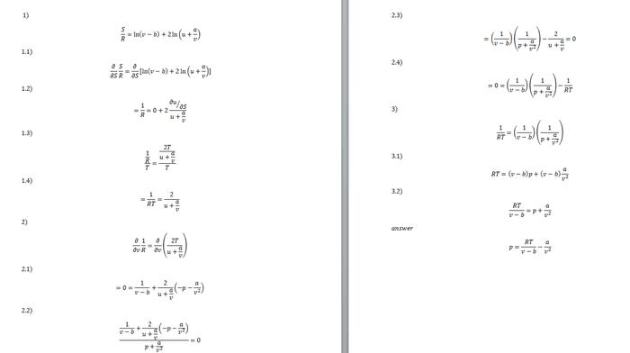

uploaded my work in image format.
One of the main problem I have is that we haven't learned multivariable integration(or partial integration I don't know what it's called.)

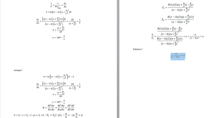

more attempts

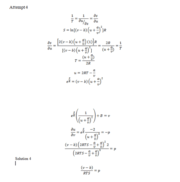

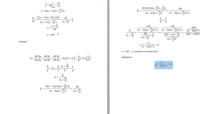

Hey Chet. In my previous posts I listed how I derived au/av from the chain rule in implicit differentiation. They might not be correct but
au/av=e^(S/R) (-2/(u+a/v))^3 is what I got for fourth attempt
au/av= 2R[((u+a/v)(-a/v^2)]/[(v-b)(u+a/v)^2]/[2R((v-b)(u+a/v))/((v-b)(u+a/v)^2)] is what I got for my second attempt
au/av=-2R/(v-b)(u+a/v)(v^2)/[(2R/(u+a/v))+1/T] is what I got on the third attempt
my derivation are all in the photos.(Not that I think they are right :(. So far unfortunately only my last attempt actually gave me a expression with T in it, T always somehow cancels out in the end in other attempts.
I took a simpler/different approach
the answer looks appropriate but I'm not sure if I messed up somewhere.

Hi Chet, yes it matches the results from my last attempt. If I sub in U=2RT-a/v for U in your answer I would get p=RT/(v-b)-a/v^2
[tex]\left(\frac{\partial U}{\partial V}\right)_S=-\frac{(2RT-a/v+a/V)}{2(V-b)}+a/V^2=-P[/tex]
[tex]\left(\frac{\partial U}{\partial V}\right)_S=\frac{(RT)}{(V-b)}-a/V^2=P[/tex]
I forgot to mention. Thank you for the help Chet! I really appreciate it.
