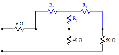

Could anyone check my answer please ?

What is RT? What is the total resistance?
Usually an answer is easier to check than to get - calculate voltages and currents and see if they work out.
Why are you taking ##R_1## and ##R_2## to be in parallel? Here's what your circuit looks like after your ∇ to Y transformation:

Just to be clear, your 6.22 Ohm answer is clearly wrong for the reason outlines by gneill.
26%7D%5C%5C%5C%5C%3D6+%5Cfrac%7B15%7D%7B26%7D+%5Cfrac%7B609%7D%7B26%7D%3D30%20%5COmega.gif
  • 26%7D%5C%5C%5C%5C%3D6+%5Cfrac%7B15%7D%7B26%7D+%5Cfrac%7B609%7D%7B26%7D%3D30%20%5COmega.gif
Much better!
