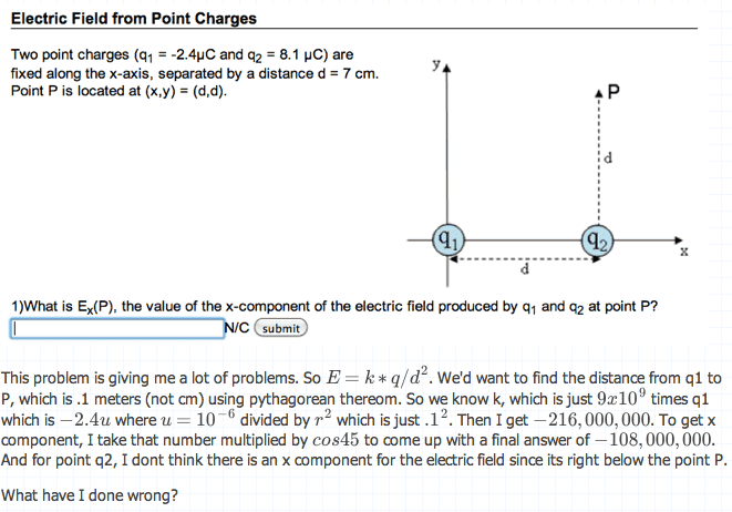

To calculate the electric field at a point, you need to know the charge of the source creating the field and the distance between the source and the point. The formula for calculating electric field is E = kQ/r^2, where k is the Coulomb's constant, Q is the charge of the source, and r is the distance between the source and the point.
Yes, electric field can be negative. Electric field is a vector quantity, which means it has both magnitude and direction. A negative value for electric field indicates that the direction of the field is opposite to the direction of the positive charge.
The unit of electric field is Newtons per Coulomb (N/C) in SI units. It can also be expressed as Volts per meter (V/m) in terms of electric potential difference.
To calculate the electric field due to multiple point charges, you need to calculate the electric field at the point due to each individual charge and then add them vectorially. The resulting electric field at the point will be the sum of the individual electric fields.
Electric field is a fundamental concept in physics and plays a crucial role in understanding the behavior of charged particles. It helps explain the forces between charged objects and is used in various applications such as electronics, electromagnetism, and particle accelerators.
