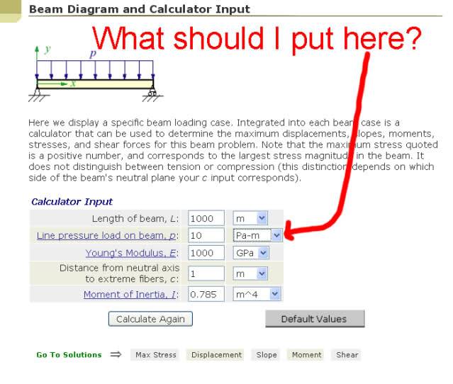

Well, you could use the standard deflection formula for a udl on a simply supported beam, in order to get an initial idea (the formula with 5/384 as its coefficient, but it needs careful interpretation...
This way will give you a rough idea, if the deflections are small.
If the answers look crazy, then this simple linear model is no use and you would probably need to make a computer model to solve the problem.

For small deflections using [5*w*L^4]/[384*E*I], you would need w, the weight per unit length, and then its component perpendicular to the rod, and take L to be be the actual length of the rod between supports. (You can also use the actual weight per unit length, and the projected length of L on to the x-axis - you get the same result) If the deflection is say less than span/200, then that is a small deflection and credible. If it is more than that, then further work is needed on the deflected shape.

I think that the last one is most suitable in spite of the fact that there is no load-just uniform rod, so I chose that one and the calculator appeared there (http://www.efunda.com/formulae/solid_mechanics/beams/casestudy_display.cfm?case=simple_uniformload), I put some values there:
Length of beam, L-Let it be 1 000 meters.
Line pressure load on beam, p: as I know in my case it will simply be the weight per meter length. So, if my rod’s radius is 1 meter then the volume of rod’s this part would be 3.14 m^3. As for its mass, if I use Carbon nanotubes their density varies between these values: 0.037-1.34 g/cm^3 (http://en.wikipedia.org/wiki/Specific_strength). Let’s take some medium value-0.1 g/cm^3, so the mass of that part will be 314 kg. But how can I transform this value to Pa-m?
Young's Modulus, E: for Carbon nanotubes is equal to 1 000 GPa http://en.wikipedia.org/wiki/Young's_modulus
Distance from neutral axis
to extreme fibers
-as I know this will be the radius of the rod-1 meter
Moment of Inertia, I: it is equal to (pi*r^4)/4, so it is equal to 0.785
But my rod is inclined by 45 degrees, what should I do with this circumstance? :shy:
So, what should I do now? :smile:
