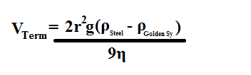

I'm going to be doing an experiment to determine the viscosity of golden syrup by dropping different size steel ball bearings into a jar of golden syrup and recording how long it takes for them to travel a certain distance when there at terminal velocity.
so from the formula I'm trying to calculate eta, but I must do this by plotting a graph and then calculating eta from the gradient
I think I'm going to have to plot radius^2 on one axis and Vterm on the other axis but I'm not sure which goes which. and then I'm going to make the equation in the same format of y=mx but I'm not sure again how
is this correct vterm on y-axis and r^2 on x-axis and then the equation of the line would equal = (vterm=2g(ps-pg))/9eta *r2 +0 and then from this
eta = 2g(ps-pg) / 9*gradient ?
