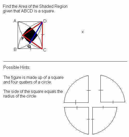

I had it on a math competition today and I couldn't think of anything. Express using variables.
Any insights guys?
http://img87.imageshack.us/img87/8684/math1wy.jpg

Do you know the area of a sector of a circle? Can you find the area of a similar shape whose vertex is not at the center of the circle? If so, then you can find the area of this shaded region.
^ Sorry... I don't.
I'm a high school senior if that matters.
Actually, it's a very simple calculation. You can just treat the required area as the sum of 4 equal segments (not sectors) of the circle plus the inscribed square.
To find the area of one segment use the formula [tex]a = \frac{1}{2}r^2(\theta - \sin\theta)[/tex]. [tex]\theta[/tex] is labelled as angle PDQ in the attachment.
To find [tex]\theta[/tex], observe that two of the quarter-circle arcs meet at a point corresponding to a vertical distance halfway along the side of the square (in order to preserve symmetry). An equilateral triangle PDC is formed by 3 lengths, one of them being the side of the circumscribing square (DC) (which is also the radius of the circle) and the others being the chords going from the corners of the square to the circle. Hence the angle subtended by the chord and the side of the square angle PDC is [tex]\frac{\pi}{3}[/tex]. [tex]\theta[/tex] can be calculated from this by subtracting [tex]\frac{\pi}{4}[/tex] and doubling, i.e. [tex]\theta = 2(\frac{\pi}{3} - \frac{\pi}{4}) = \frac{\pi}{6}[/tex].
The rest of the calculation is easy. Just plug in the value of theta to find the area of one segment and multiply by four. To find the area of the inscribed square, use the side (given by [tex]2r\sin{(\frac{\pi}{12})}[/tex] and square that. Add it all up to give the required area.
BTW, not to give away the exact answer, but I get mine as being slightly less than a third of the area of the big circumscribing square.

I got 1 + pi/3 - sqrt(3).
Thats assuming its a unit square of course (othewise just multiply by the area of the square).
I used :
Area = 2 times Area "()" plus 4 times Area "/\" minus 1 times Area of outer square.
Sorry about the cryptic descriptions of the regions but I'm too lazy to draw a proper diagram. Area "()" refers to the region that looks a bit like that and "/\" refers to the little inverted V shaped region with base BC.
This is correct, I found the same answer through a geometrical approach.
Check using calculus:
[tex]\begin{array}{l}
8\int\limits_{\frac{\pi }{6}}^{\frac{\pi }{4}} {\int\limits_{\frac{1}{{2\sin t}}}^1 {rdr} dt} = 8\int\limits_{\frac{\pi }{6}}^{\frac{\pi }{4}} {\left[ {\frac{{r^2 }}{2}} \right]_{\frac{1}{{2\sin t}}}^1 dt} = 8\int\limits_{\frac{\pi }{6}}^{\frac{\pi }{4}} {\frac{1}{2} - \frac{1}{{8\sin ^2 t}}dt} = 8\left[ {\frac{t}{2} + \frac{{\cot t}}{8}} \right]_{\frac{\pi }{6}}^{\frac{\pi }{4}} \\ \\
= 8\left( {\left( {\frac{\pi }{8} + \frac{1}{8}} \right) - \left( {\frac{\pi }{{12}} + \frac{{\sqrt 3 }}{8}} \right)} \right) = 8 \cdot \frac{{\pi - 3\sqrt 3 + 3}}{{24}} = \frac{\pi }{3} - \sqrt 3 + 1 \approx 0.315 \\
\end{array}[/tex]
I integrated over the http://www.td-hosting.com/wisfaq/cirkels.gif" , multiplied by 8.
