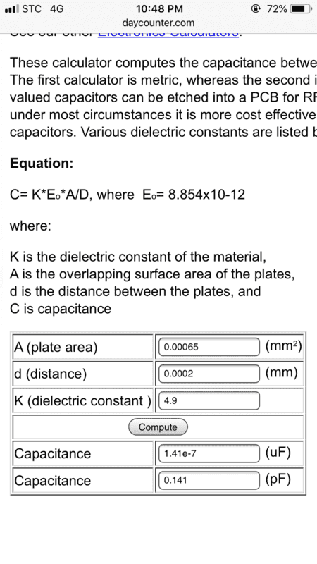

Hi all,
I have mechanical background but I came across some electrical issues when I am doing my research. I bought (ams) pcap02 to measure capacitance behavior in parallel plate capacitors for certain material using a dielectric with 4.5 relative permittivity. As known, I used the upper plate side for potential and the bottom side plate for ground! When I start measuring no anything happened at all! But when I disconnected the ground it became very sensitive to my hand or any material that touches it. Is this wrong? If so how to correct it?
Thanks in advance

This is my area and spacing and capacitance below, the device claims that is reads up to 100 nano farad
When I connect both terminals, the device gives me the same number 141 pF but when I apply any force to it doesn’t react or change the capacitance just 141 pF. When I disconnect the ground it gives me the number 47 pF which is the capacitor inside the device but any force applied to my sensor the 47 pF increases by around 10 pF

The device has a capacitor in it that has 47 pF, and I connect my capacitor to it it gives me the ratio between device capacitance and mine when I connect two terminals.
When I connect one terminal(potential) of my capacitor to the device it gives me just 47 pF ( the device capacitor) plus any reaction comes from my capacitor.
What does this mean?

The device must have two leads. You need to use both for meaningful readings.

Yeah that’s true, it gave me my capacitance correct. I mean what does mean when I disconnected one lead and gave me reading for any reaction on capacitor
You are just measuring some parasitic capacitance. As I don't know the actual layout, I can't account for what you are getting.
Your capacitor is a very low value; anything below a pF or two is pretty hard to measure. This is why I wanted to know the lower limit to the pcap02 measurement capability. The details of the way the machine is connected can add many parasitic pF's. What is the connection layout? The capacitance between two lengths of connecting wire can be 20pF or more.

I have been looking at more of the documentation about the pcap devices. They seem to be used in large quantities for many applications so they must be fairly low cost(?).
So why don't we see little boxes for sale on eBay and elsewhere which will measure Capacitors in the home electronics lab? Or are they in fact used in upmarket DMMs?
Edit: Apparently, the device has a resolution of around 10fF, which beats most component bridges by a mile - under special conditions, I would assume.

Measurement is by charge/discharge time of unknown capacitor compared to time with a 'known' capacitor. 4 floating channels or 8 common (grounded) channels, with one used for the 'known'. The chip has a selection of resistors for ranging/sample-time and a builtin CPU to do the calcs and averaging. Not sure, but I seem to recall that the CPU is user re-programmable, that may help explain its popularity.
The 47pF reading is the pre-installed capacitor on the Evaluation Kit.
If I understood the OPs question correctly, he is asking why there are bad readings with one lead of the 'unknown' capacitor disconnected. That would be stray capacitance to his hand and induced electrical noise.
The probable reason for not getting a reading is because the capacitor he is trying to measure has a small value relative to the default 47pF pre-installed ones. The device compares the charge/discharge time of the unknown capacitor to that of the capacitor on channel one. To get reasonable readings, the pre-installed capacitors must be removed and the capacitor on channel 1 must have a value close to that of the 'unknown' capacitor. It is likely that the appropriate on-chip timing resistor will have to be selected and perhaps other chip options selected in software.
There is much documentation on the AMS.com and the OP will have to understand how to operate the chip.

Yeah since talking very low capacitance values, as soon as you remove the "ground" and just measure between two plates in space, you also have to consider the capacitance into free space, moving your hand near it, or touching it will affect this significantly.

There are several things missing from your description of the experiment. Am I right in saying that the (ams) thing is a capacitance meter? What is the sensitivity of this device? Your theoretical calculation of the expected capacitance is 0.141 pico farads. That's an extremely small capacitance. I've never seen a practical circuit using a .14 pF capacitor. Are you sure your meter can detect much less measure 0.14 pF? Perhaps "nothing happened" means that there was a 0.00 reading on your meter? In which case, I'd say you are using the wrong instrument for the job. Good luck finding one that can measure capacitances that low.
As for the result you obtain after breaking the charging circuit by removing the ground connection, it's known that dielectrics have a sort of memory effect (I forget what it's called.) The molecules in the dielectric re-align themselves in the electric field of a charged cap but they often don't 'relax' as soon as the charge is drained. In fact, in some cases the voltage on the cap will jump up a bit after removing the charging current. Capacitors with an intense memory effect are useless in some electronic circuits. I'm not sure just what you mean by the ungrounded cap becoming 'sensitive' to your hand after disconnecting the ground. My best guess along the lines above is that your unknown dielectric has a strong memory effect and it's generating its own electric field after the ground circuit is broken and that your hand is displacing that field from the outside of your cap. Without more info, I'm afraid I can't be more helpful.
BTW, I recommend Scherz and Monk, "Practical Electronics for Inventors" as a good intermediate level electronics text. It covers theory and also practical matters like the properties of the various kinds of capacitors, such as the memory effect I mentioned. Unfortunately, it contains a lot of errors, too. If something doesn't make sense, it might be the authors, not you who are to blame. Despite these, I've learned a lot from it.
