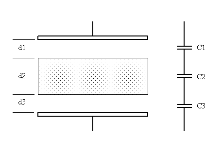

A parallel plate capacitor with plate area A = 100 cm^2 and plate separation of d = 5mm is connected to a 120 Volt power supply and allowed to fully charge.
a) Calculate the capacitance, stored charge, electric field midway between the plates and potential energy stored.
The capacitor is disconnected from the power supply and then a sheet of glass of thickness b = 2mm with dielectric constant κ = 4.5 in place between midway between plates.
b) Calculate the electric field inside the dielectric and in the gaps between the dielectric and the capacitor plates.
c) Hence calculate the voltage across the plates, and thus the new capacitance.
d) Calculate the new stored energy and determine whether work was done or given out as the glass plate was inserted.

Inserting the dielectric creates three regions between the outer plates. Two have the same field as the original capacitance since the field outside a charged plate is tied to its charge density (and the charge on those plates hasn't changed). You know the width of those regions from the geometry of the setup. You have the "new" field strength for the region filled with the dielectric, and you also know its width.
So sum the potential changes implied by the fields and their widths. Go from there.

So I've separated the system into the three regions and marked on it the separation widths and field strengths. However I'm not clear on what you mean by summing the potential differences and the widths..
Three regions: Two air gaps and a dielectric region:
I suppose you could merge the two air gap regions into a single region (pushing the dielectric up or down to fill one gap).
If you have a field E in a region of width d, with the field oriented along the path of d, then what is the potential difference across d?

V = ∫E ds = E1*d1 + E2*d2 + E3*d3. You know d1 and d2, also E1 and E2, so you can easily compute V.

Sorry for the lateness in my reply. Ah yes I think I see what you mean now. Is it that I now invoke the relation that V = -E*d (multiplication since the field E is oriented along the path d and so there is no angle between them)? Thus I'd find V in each of the three regions (or two if I go about it as you mentioned) and then sum them up to get the total voltage across the two plates.
Right. I posted too late!
