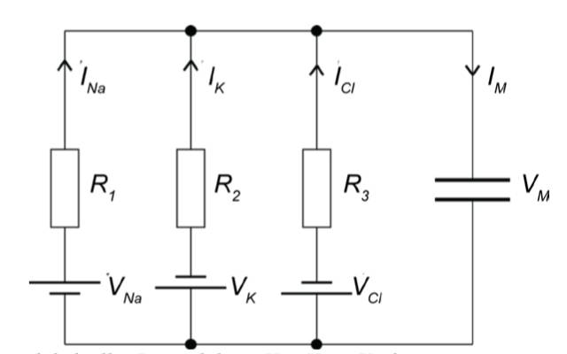

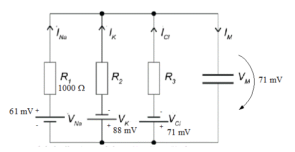

[QUOTE="mini, post: 5163753, member: 562889"] [ATTACH=full]179689[/ATTACH] We know that - V[SUB]M[/SUB]=V[SUB]Cl[/SUB] - R[SUB]1[/SUB]=1000.0 Ω - I[SUB]M[/SUB]=0 - V[SUB]Na[/SUB]=61 mV - V[SUB]K[/SUB]=-88 mV - V[SUB]Cl[/SUB]=-71 mV Question is: what is R[SUB]2[/SUB]?I've written according to Kirchhoff's second law that (1) V[SUB]M[/SUB] + V[SUB]Na[/SUB] - R[SUB]1[/SUB]I[SUB]Na[/SUB] = 0 and (2) V[SUB]M[/SUB] - V[SUB]K[/SUB] - R[SUB]2[/SUB]I[SUB]K[/SUB] = 0. We can also calculate that I[SUB]Cl[/SUB]=0. With these equations and according to Kirchhoff's first law we can solve (using absolute values) that R[SUB]2[/SUB]=128.789 Ω that is a correct answer. The problem is that I wonder why V[SUB]M[/SUB] is always positive? Shouldn't it be negative in the first equation? If we go through capacitor and then Na-part of the circuit, the capacitor will have a negative charge at the bottom and a positive charge at the top because so has V[SUB]Na[/SUB]. (Instead, if we continue to K or Cl part of the circuit, the capacitor will have a positive charge at the bottom and a negative at the top.) So the first equation would be -V[SUB]M[/SUB] + V[SUB]Na[/SUB] - R[SUB]1[/SUB]I[SUB]Na[/SUB] = 0 but then we get an incorrect answer. I see that I must have misunderstood something but I don't know what is it. [/QUOTE]
