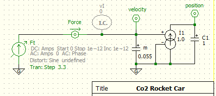

I've used CircuitMaker Student Version SPICE in the past to model the Estes Rocket Car and the Mythbuster's JATO Powered '67 Chevy with simple models for driveline friction. Voltage at a grounded capacitor is velocity in the simulator. Current into the capacitor is force. And capacitance is mass. This solves the impulse-momentum integral by applying the force-current analog. The CM Student has an math integrator block to find position by integrating velocity, and ideal transformers can be used to couple the rotational load to the translational load. The 5Spice is a better interface for beginners, but it appears to have no integrator math block. If it has the integrator (still trying to figure that out), we could begin to study your drag reduction models to see how much time is saved coasting for say 0.7 seconds over a known distance. Without the integrator velocity and time are available but distance is unknown.

I've built the basic simulator model in 5Spice with a step force input F(t) = 3.3 Newton for 0.3 seconds. Mass m = 0.055 kilogram gives about 18 meter per second velocity at 0.3 seconds. Figured out how to integrate velocity using a clever trick where position change is less then 3 meters during this thrust model. Only problem here is acceleration is still hidden, but I think 5Spice is the first tool to use if it runs on your PC. I know it will handle the drag feedback model and may be able to handle a complex friction model eventually (not sure on that score). Graphical output from the Transient Analysis is rapid and clean.
