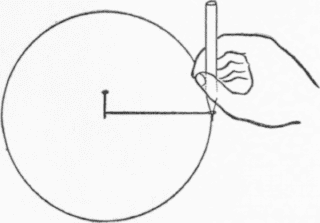

Does this picture explain what a "center of curvature" means?

You mean we should complete the curved surface by making a circle and then center of this circle will be called "center of curvature" .Right?
That is not necessary! Just looking at an arc of the circle is sufficient. I can take the pencil and draw just a segment of the circle. That section alone tells me where the center of curvature is.
To expand on this, the reason is that the circle looks the same everywhere because it is so symmetrical. If you have one tiny segment of a circle, you know what the rest will look like. And thus you know the center of that circle, the center of curvature.

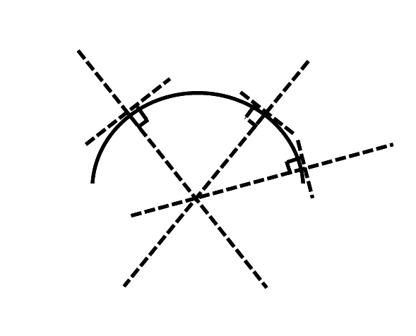

One way to determine the center of curvature would be a line perpendicular to the curved path, with length equal to the radius of curvature. Wiki article (includes link to radius of curvature):

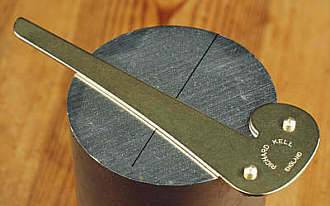

Centre Finder...
