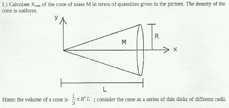

Calculate the X_com of the cone of mass M in terms of quantities given in the picture. The density of the cone is uniform.
See the attachments for the picture.
