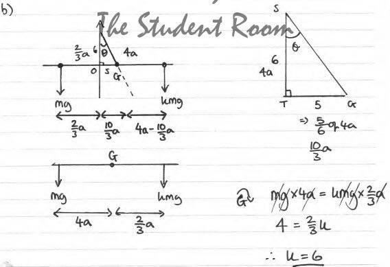

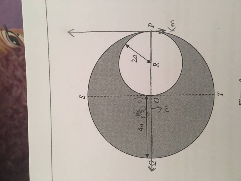

A uniform circular disc of radius 4a with a circular hole of radius 2a made in the disc.
The mass of L is m and a particle of mass km is now fixed to L at the point P. The system is now suspended from the point S and hangs freely in equilibrium. The diameter ST makes an angle a with the downward vertical through S, where tana=5/6
Find the value of K
Disc before adding weight km at point P has a mass m of coordinates (10/3,0).

The center of mass is on a line that goes from S downwards. If P is lower than Q, then it is to the right of the geometric center of the large disk. It does not have to be - for small values of k the hole is more important and the center of mass would be to the left.
