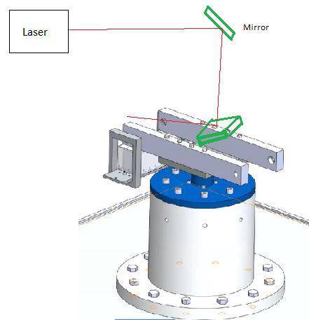

How does powder behave under centrifugal force? Let's imagine that we put the powder in a box and start rotating it. How can I understand how the powder will behave? Will it be flat and stick to the outer side of the box or...?
No equations are required. Knowing ansys probably would help
Welcome to PF.
Do you mean like a rectangular box? What axis is the axis of rotation? Can you post a sketch?
And where does the "Laser" come into this?
How much powder is there in this "box"? Is it half-full? 1/10th full? What kind of powder? What is the spin rate?

First of all, thank you for answering. I have to design an innovative apparatus that is based on selective laser sintering (basically it is 3D printing), but our idea is to make the box with powder (for ex aluminum) spin so centrifugal force will compress the powder making it denser. The laser comes from outside and should be probably directed by mirrors. We are not quite sure about the idea, we don't really know how powder behaves when the box is spinning. Overall, the goal is to make the powder flat and to point a laser beam to create a part. Idk, maybe you will have some creative solution for us)

Thank you for answering! Centrifugal force and you can assume that powder is like a fluid (water maybe, but denser). In fact, we will be using aluminum powder. Here is the design. Maybe you have a creative solution to make a powder in the box, which is spinning, flat. And how would you design mirrors so they will direct laser beams into the box?

To aim a laser at the inner surface, one would need to aim the laser into the interior of the chamber (box) and hit a 45° angle mirror to deflect the laser beam from vertical to horizontal.
Has one thought about the traverse of the sintering laser on the surface of the box?
