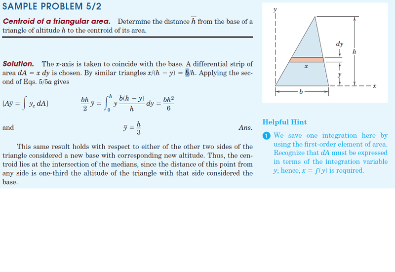

See attachment
If the y-coordinate of the center of mass is given by (1/A)*∫y dA, how come the solution uses bh/2 as the area? This triangle isn't right angled so that area formula should not hold. What am I missing?
The area of any triangle is given by bh/2, not just a right-angled one.
Drop a perpendicular from the top of the triangle to the base, cutting it into two right triangles. Say this meets the base a distance c from the lower left corner.
The two right triangles have areas ch and (b-c)h. Add them up.
Likes sysprog and hutchphd

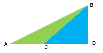

The formula works with scalene triangles too. Suppose you are looking for the area of the green triangle ABC. First find the area of the big right triangle ADB and subtract from it the area of the smaller blue right triangle CDB.
##A_{\text{ADB}}=\frac{1}{2}(BD)\times(AC+CD)##
##A_{\text{CDB}}=\frac{1}{2}(BD)\times(CD)##
##A_{\text{ABC}}=\frac{1}{2}(BD)\times(AC+CD)-\frac{1}{2}(BD)\times(CD)=\frac{1}{2}(BD)\times(AC)=\frac{1}{2}(\text{height}\times\text{base}).##
