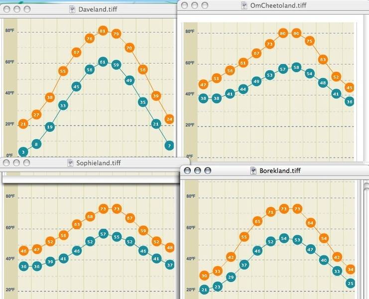

Comparing temperatures of a few of the responders:
It's obvious that you've got the highest temperature gradient in the winter. And if that really is just an enclosed porch who's only heat source is the wood stove, the studs are going to be ice cubes if the fire goes out. And as SophieC stated, their heat capacity is going to cause them to take a lot longer to warm up.

I'm going to go out on a limb and state that I'm 99% positive that the walls and ceilings are insulated, and the soot is a result of studs being the cold spot.
Borek's January temperatures, and observations regarding the screws, seem to support the hypothesis.
