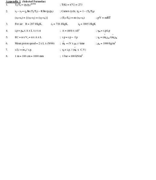

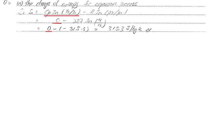

Can someone explain to me why Cpln(T2/T1) = 0?
Thank you.
Thank you.
Expanding isothermally means that T2 = T1.
Ok sorry... I forget about this concept. sorry thanks for your explanation Chestermiller :)
