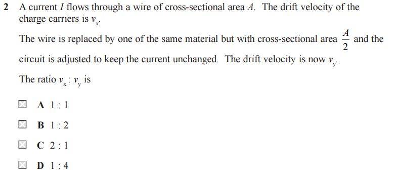

Charge carrier drift velocity of wire
Current is I = nqvA so drift velocity V is: V = I/nqA
Drift velocity for x is: Vx = I/nqA
Drift velocity for y is: Vy = 2I/nqA
So the ratio of Vx : Vy should be 2:1 since Vy is equal to 2 lots of Vx?? (but correct answer is B)

Nothing seems wrong with your calculation. Answer should be 2:1. But books sometimes give wrong answers.

I've done this question a few times now and ended up with the same answer, but the question is from an official exam paper in the UK so I don't believe there's been a mistake.

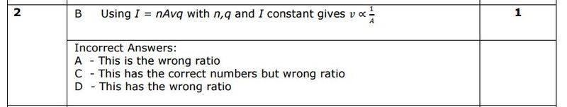

FYI, here's what the mark scheme says:
How can it still be B?

I'm retracting my edit from before. Clearly the coffee isn't working this morning :smile:
If the cross sectional area is halved the velocity doubles. So Vy is twice Vx as you originally pointed out:
So ##V_y## is twice the size of ##V_x##. That makes the ratio ##V_x:V_y = 1:2## which is indeed answer B.
So ##V_y## is twice the size of ##V_x##. That the ratio ##V_x:V_y = 1:2## which is indeed answer B.
Indeed. Vy/2=Vx , so Vx: Vy should be 1:2 because then Vy÷2=1.

Vx = I/nqA
and
Vy = 2[I/nqA] = 2Vx
so doesn't that mean that for every 1 part of Vx we have half a part of Vy? So that 2 parts of Vx gives 1 part of Vy so the ratio is still C, 2:1?? Argh!

Pick a value for the magnitude of Vx, say 1. What value would you assign to Vy using your expressions?

2Vx=Vy. So , if the value of Vx is 1, value of Vy should be 2 right?

Right. So, Vx = 1, Vy = 2. What's Vx:Vy?
Then Vx:Vy should be 1:2
