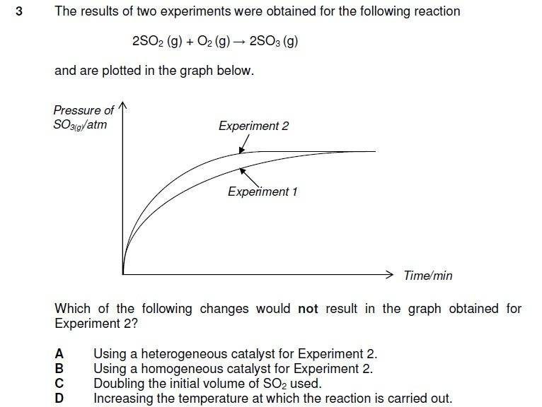

Chemical Kinetics Qn: Why is D Not a Possible Answer?
In summary, the correct answer is C because doubling the initial volume of SO2 leads to an increase in the moles of SO3 produced, resulting in a higher pressure. However, D is not a possible answer because although increasing the temperature increases the rate of reaction, it also changes the equilibrium composition and the pressure of sulfur trioxide. This change in pressure is dependent on whether the reaction is endothermic or exothermic, and is not reflected on the graph.
nicholaschean
The correct answer states its C which i understand why since doubling the intiial volume of SO2 is equivilent to doubling the intial moles of SO2 hence the moles of SO3 produced will also increase and hence pressure exerted shld be higher than before which is not reflected by the graph.
However, why is D not a possible answer? When temperature increases, the reactant particles will gain energy and cause rate of reaction to increase which is reflected by the graph here. But the SO3 particles produce will also be more active compared to lower temperature in experiment 1, hence shouldn't it exert a higher pressure than experiment 1? which in this case is not shown on the graph.
Increasing the temperature will change the equilibrium composition, and your sulfur trioxide pressure would have a different horizontal asymptote.
The asymptote will move up or down depending on whether the reaction is endothermic or exothermic.
Note that increasing temperature WILL increase the rate of reaction.
